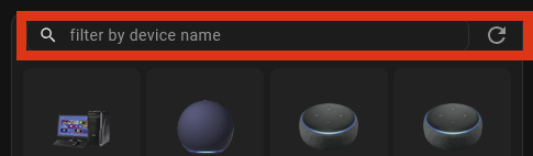

Is it possible to hide the media-browser-control-filter?
@woempiej
Unfortunately no, not at this time.

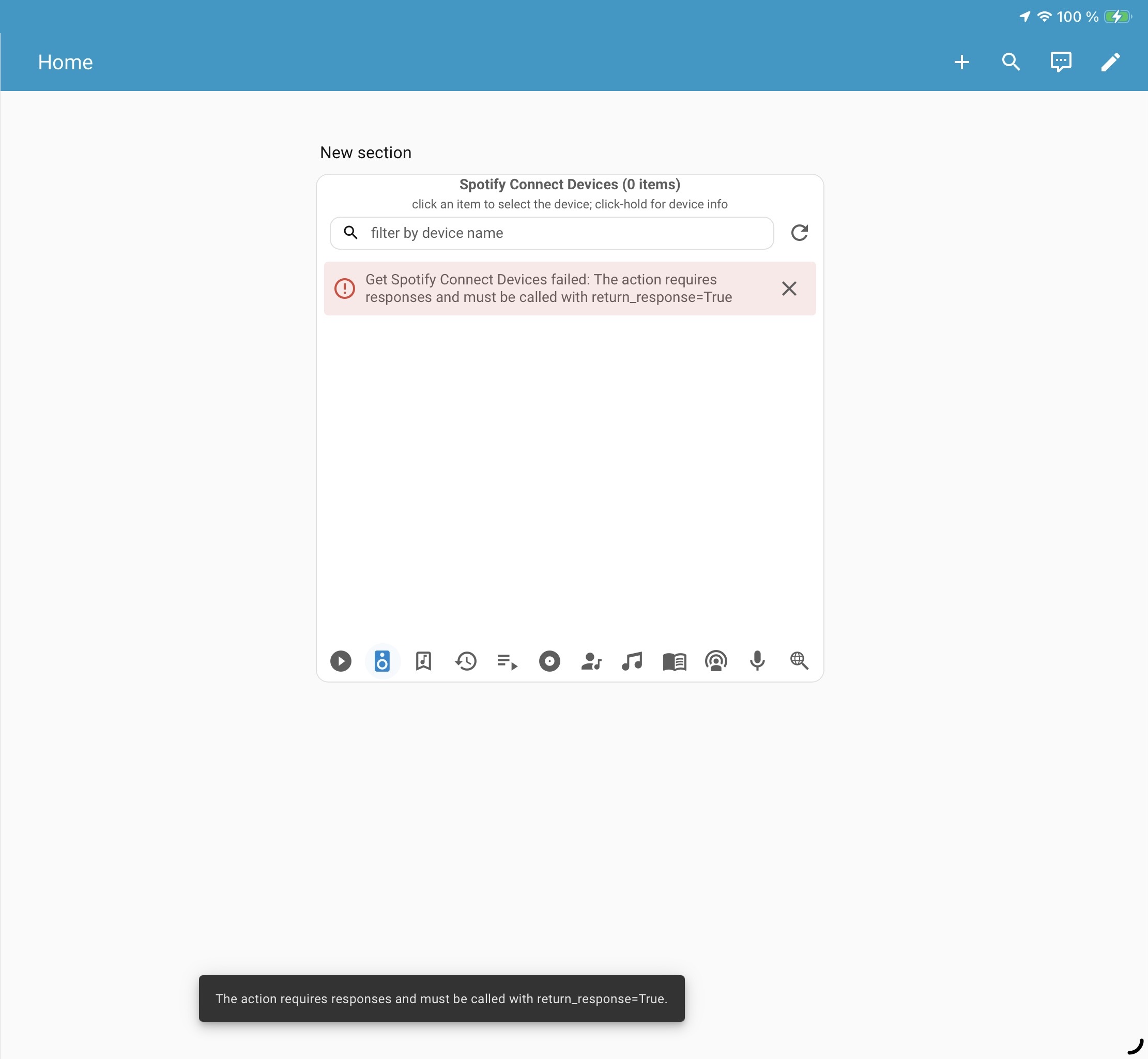

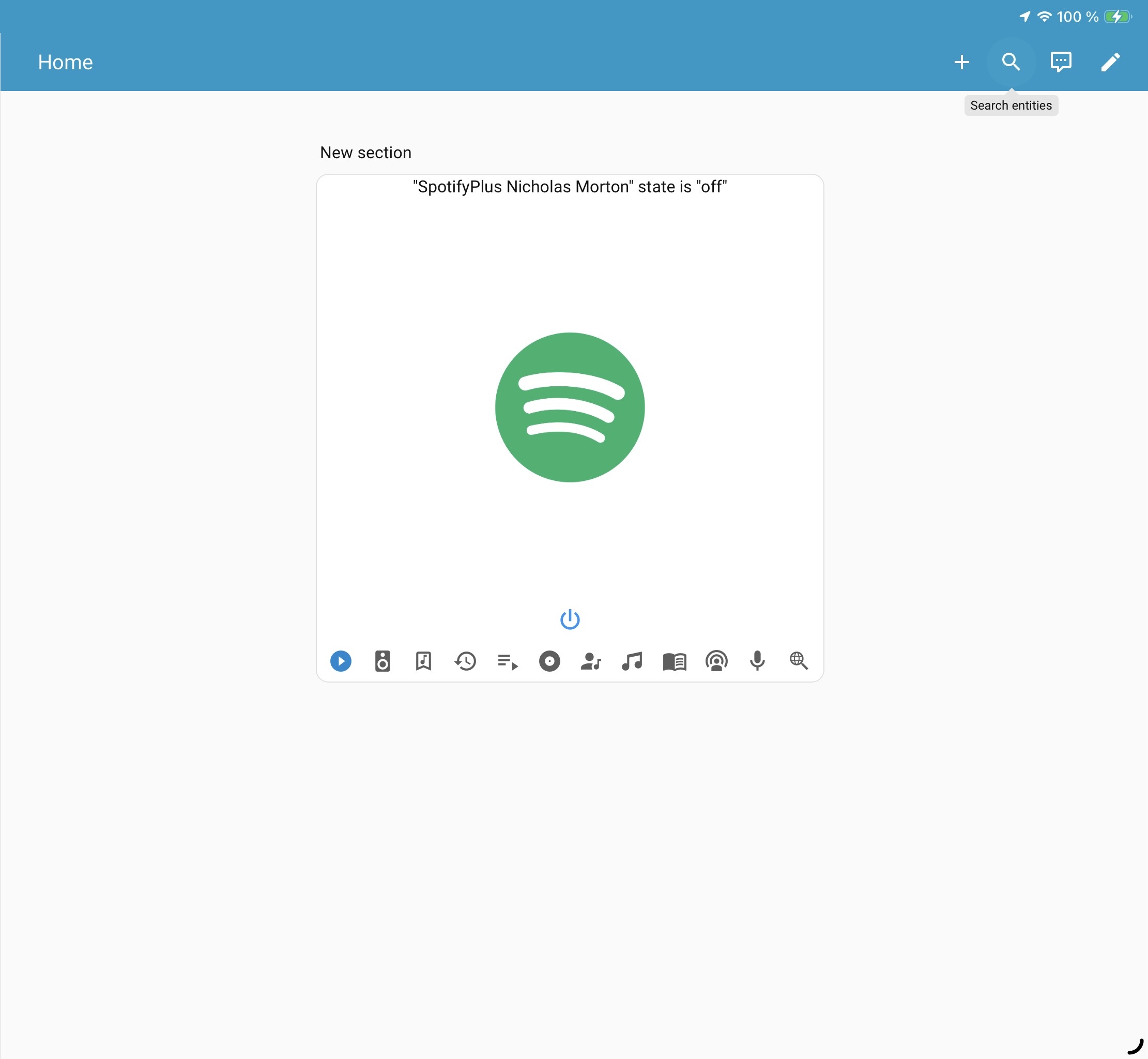

I see no problem with SpotifyPlus, and can play Spotify from the SpotifyPlus card, but non of the the other stuff works. Yes I’m Spotify premium.
@tormodnt
Can you post your SpotifyPlus Card YAML as well please?
I have one other user that is experiencing this issue, and still have not figured out what it is. SpotifyPlus Card issue 88 is opened for him. You might take a look through there and see if anything jumps out. I initially thought it was a caching / cookie issue, but still am not sure as it is not happening for any other users (besides you now). I am leaning toward a conflict with another plugin / dashboard, but not sure on that either.

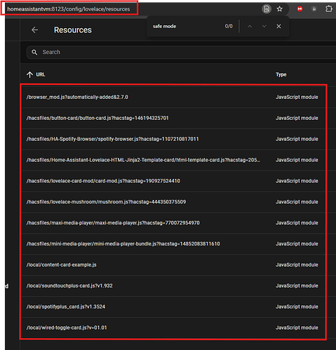

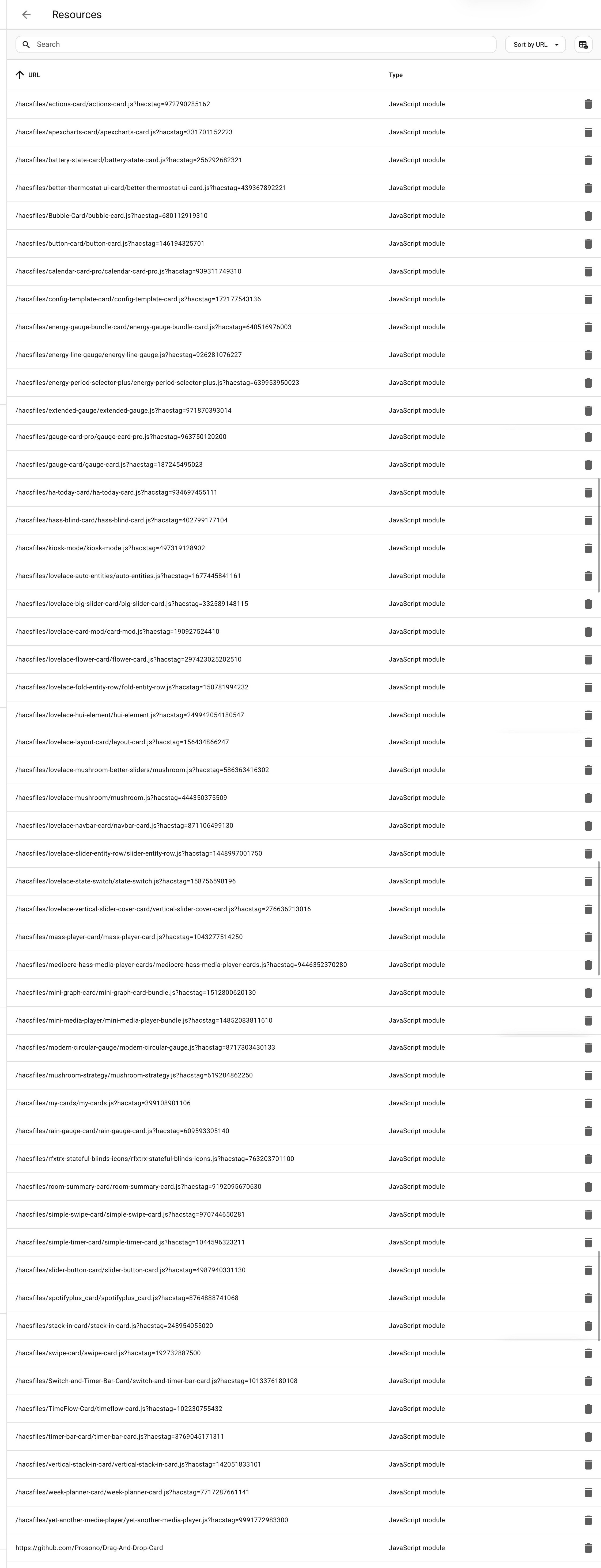

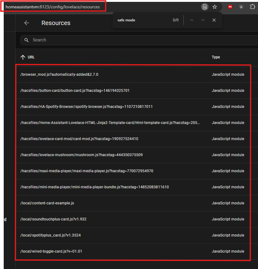

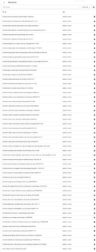

Can you provide a screenshot of the resources that you have defined on your system? We might be able to compare the resources that you have defined with the resource list from the other user and see if there is anything in common that might be causing the issue.
For example, here are the resources I have on my VM dev HA instance:
Hope it’s readable. Had to stitch several images.
@tormodnt
Thanks. I will send this to the other person to see what resources he has in common with yours, to see if we can narrow down the possible conflicts.
Here’s the list in text format.

I compiled a list of resource entries that were the same between your environment and the other user (see below). I installed all of those resources, and could not reproduce the error after restarting HA.
Duplicate Resource List
- /hacsfiles/apexcharts-card/apexcharts-card.js
- /hacsfiles/battery-state-card/battery-state-card.js
- /hacsfiles/Bubble-Card/bubble-card.js
- /hacsfiles/button-card/button-card.js
- /hacsfiles/calendar-card-pro/calendar-card-pro.js
- /hacsfiles/config-template-card/config-template-card.js
- /hacsfiles/kiosk-mode/kiosk-mode.js
- /hacsfiles/lovelace-auto-entities/auto-entities.js
- /hacsfiles/lovelace-card-mod/card-mod.js
- /hacsfiles/lovelace-fold-entity-row/fold-entity-row.js
- /hacsfiles/lovelace-layout-card/layout-card.js
- /hacsfiles/lovelace-mushroom/mushroom.js
- /hacsfiles/lovelace-navbar-card/navbar-card.js
- /hacsfiles/lovelace-state-switch/state-switch.js
- /hacsfiles/mass-player-card/mass-player-card.js
- /hacsfiles/mediocre-hass-media-player-cards/mediocre-hass-media-player-cards.js
- /hacsfiles/mini-graph-card/mini-graph-card-bundle.js
- /hacsfiles/mini-media-player/mini-media-player-bundle.js
- /hacsfiles/room-summary-card/room-summary-card.js
- /hacsfiles/simple-swipe-card/simple-swipe-card.js
- /hacsfiles/spotifyplus_card/spotifyplus_card.js
- /hacsfiles/stack-in-card/stack-in-card.js
- /hacsfiles/swipe-card/swipe-card.js
- /hacsfiles/vertical-stack-in-card/vertical-stack-in-card.js

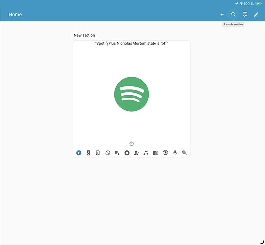

I’m wondering if it’s the way the dashboard is configured (that contains the SpotifyPlus card) maybe? or is there anything in your configuration.yaml that might be loading a global resource maybe? For example, something that affects all dashboards?
You might try the following, which will create a new (empty) dashboard and add a new SpotifyPlus Card instance. Just want to make sure there are no other card types on the dashboard to interfere (e.g. auto-entities, card-mod, config-template-card, mushroom, mini-graph-card, etc).
  • Go to Settings \ Dashboards.
  • click on Add Dashboard button to create a new dashboard.
  • select new dashboard from scratch - shows add dashboard dialog.
  • enter new dashboard details:
    • title = SpotifyTest3
    • icon = nothing (default value)
    • url = dashboard-spotifytest3 (default value)
    • Admin only = false (default value)
    • Add to sidebar = true (default value)
  • click Create button to create the new dashboard.
  • click SpotifyTest3 menu item in left sidebar to select the new dashboard.
  • click pencil icon in upper right to edit the new dashboard.
  • click create section in the bottom tile to create a new section.
  • click the plus (e.g. +) icon under the New Section title - shows the Add to dashboard dialog.
  • enter spotify in the search cards textbox to filter the available cards list. this should display the SpotifyPlus card picker.
  • click the SpotifyPlus Card entry to add the card - shows the SpotifyPlus Card Editor UI dialog.
  • towards the middle left, click on the select an entity* field to select your SpotifyPlus integration instance.
  • click Save button to save the card.
  • click done in the upper right to finish editing the dashboard.
  • it should now display the SpotifyPlus Card instance in the SpotifyTest3 dashboard.
  • click on the Devices tab in the card footer area (speaker icon, 2nd from left). This should display the available Spotify Connect devices (or the return_response error message if it’s still not working).
