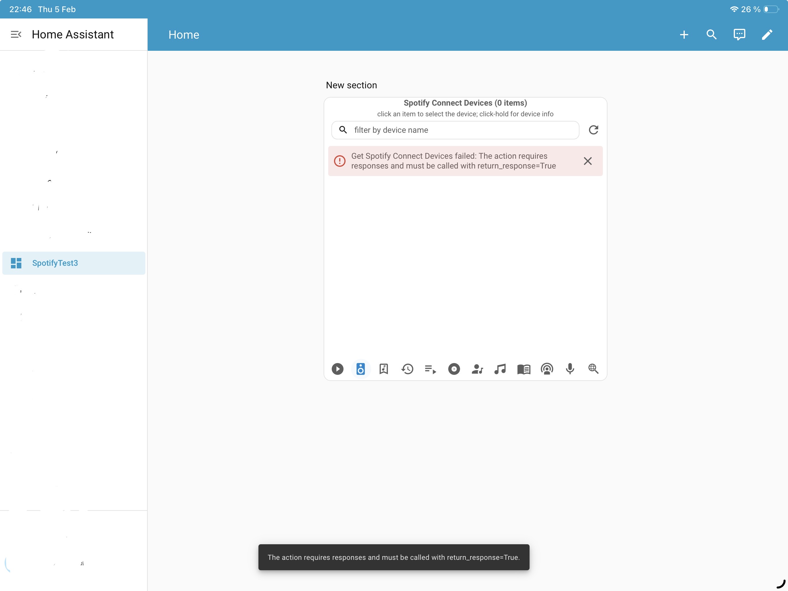

That rules out issues with the dashboard.

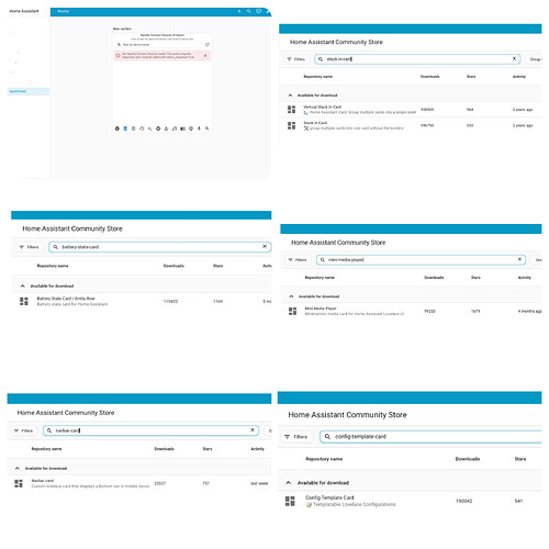

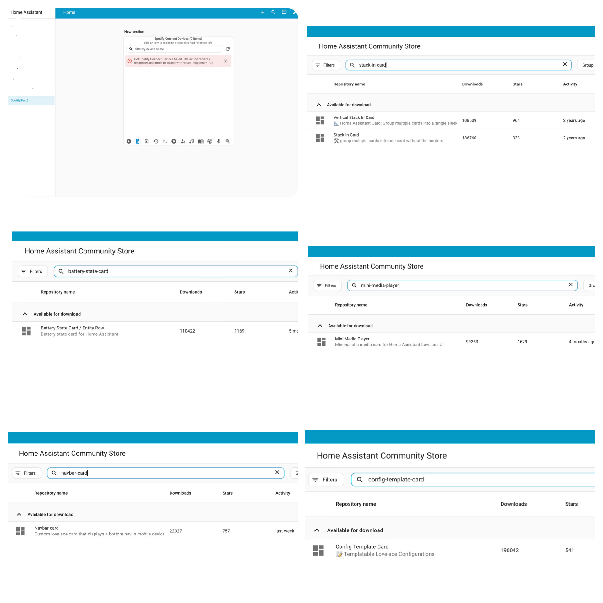

I am still leaning towards a conflict with another card / resource. I did some more searching on the error message, and found this thread that talked about the same issue (with another integration). They used the following to diagnose the issue and determine which resource was causing the problem:
I eventually managed to figure out which card caused the conflict by moving all the cards except the irrigation unlimited card out from the www/community folder, after which the irrigation unlimited card started working. I then copied back card by card, refreshing the browser each time, until I found the culprit.
You might try the same - move all folders (except the spotifyplus_card) out from the /config/www/community folder. At this point, the SpotifyPlus Card should start working. You can then copy each of the folders back (one-by-one), hard-refreshing the browser after each folder is copied back and clicking on the SpotifyPlus Card devices refresh button to refresh the list.
@tormodnt
So I did some more research on the possible card suspects. I looked at the repository source in each one to determine what version of the “home-assistant-js-websocket” module they were importing in package.json. The following have a version less than 9.2.0, which can cause the “action requires responses” error:
* /hacsfiles/battery-state-card/battery-state-card.js   	"home-assistant-js-websocket": (not in package.json, dependency of custom-card-helpers = "home-assistant-js-websocket": "^6.0.1")
* /hacsfiles/config-template-card/config-template-card.js	"home-assistant-js-websocket": "^5.11.1",
* /hacsfiles/lovelace-navbar-card/navbar-card.js		"home-assistant-js-websocket": "^6.0.1"
* /hacsfiles/mini-media-player/mini-media-player-bundle.js	"home-assistant-js-websocket": "^6.1.0",
* /hacsfiles/stack-in-card/stack-in-card.js			"home-assistant-js-websocket": "^5.7.0",
I would bet that it is one of the above that is causing the problem.
Sorry, had much to do so haven’t gotten back to you.
Tried removing everyone on your list, did a full restart.
Error still there.
@tormodnt
Try the following … move all folders (except the spotifyplus_card ) out from the /config/www/community folder. Then restart HA and clear your browser cache (including cookies). At this point, the SpotifyPlus Card should start working. You can then copy each of the folders back (one-by-one), hard-refreshing the browser after each folder is copied back and clicking on the SpotifyPlus Card devices refresh button to refresh the list.

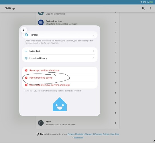

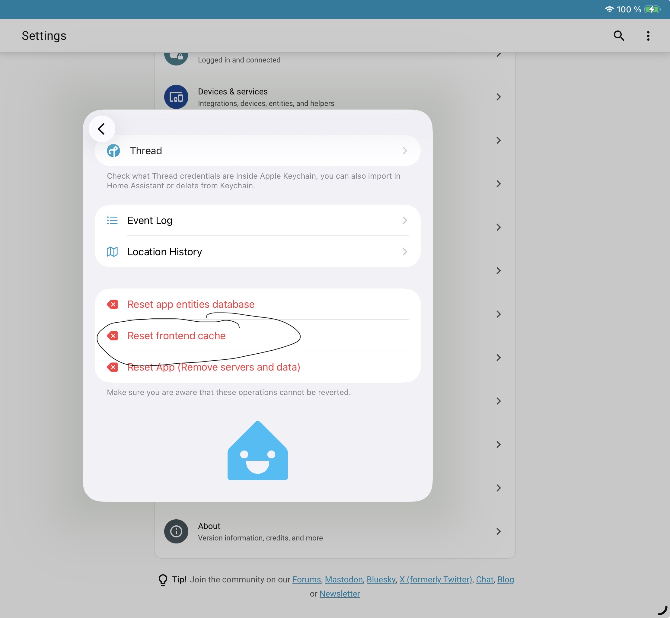

Done that, I’m on a ipad using the HA app, so did the companion app/debugg/reset catch option that I use when I do any major changes to my picture element dash.
Nothing changed, same error
@tormodnt
Any chance you can use Google Chrome on a desktop browser? Mobile and Tablet browsers pretty much cache everything, as well as the HA Companion App.
You need a browser where you can do a hard refresh between moving individual cards back into the /config/www/community folder.

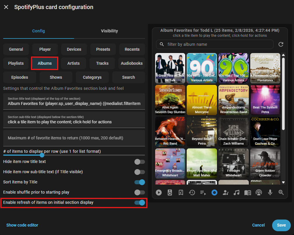

Just released SpotifyPlus Card v1.0.69, which adds auto-refresh capabilities to each of the sections. It also corrects rendering of dropdown list controls when using HA 2026.02.x.
To enable auto-refresh, you must add the following configuration options (omit the ones that do not need auto-refresh):
albumFavBrowserItemsRefreshOnEntry: true
recentBrowserItemsRefreshOnEntry: true
playlistFavBrowserItemsRefreshOnEntry: true
artistFavBrowserItemsRefreshOnEntry: true
trackFavBrowserItemsRefreshOnEntry: true
audiobookFavBrowserItemsRefreshOnEntry: true
showFavBrowserItemsRefreshOnEntry: true
episodeFavBrowserItemsRefreshOnEntry: true
They are also configurable via the Card Editor UI (example for Album section):
Please let me know if you have any issues.
Thanks!

@tormodnt
I had a third user report the “action requires responses” error, and gave him these instructions to try and resolve. He followed the instructions, and was able to resolve the issue - the problem was caused by the Popup view integration. I am not sure if that was in your list of installed cards or not, but thought I would mention it.
These instructions are more detailed than what I outlined above. Give them a try and see if it helps.
In the case of the Popup View integration, it looks like it was intercepting ANY service calls made and checking for the popup_view domain (see code below). If not, then it would just call the original service using originalCallService.call(this._hass, domain, service, data, target) - note the omission of the return_response argument!
This is concerning, as it could be an integration that is causing this instead of a managed resource! Note that the Popup view integration has an embedded javascript component, which is actually overriding ANY calls made to the hass.callService() method!
Popup View source code
    interceptServiceCalls() {
      const originalCallService = this._hass?.callService;
      if (originalCallService && !this._intercepted) {
        this._intercepted = true;
        this._hass.callService = (domain, service, data, target) => {
          if (domain === 'popup_view' && service === 'open') {
            data = { ...data, _session_id: this.sessionId };
          return originalCallService.call(this._hass, domain, service, data, target);
