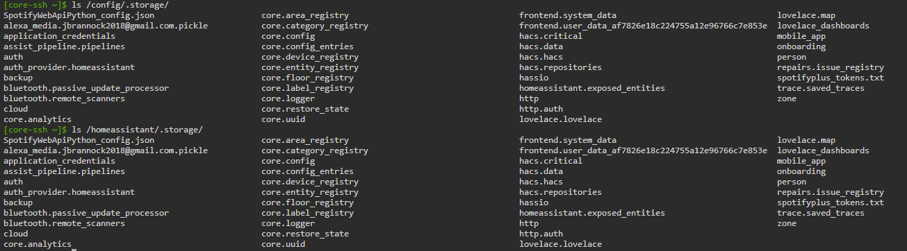

Can you provide a screen capture (or list) of what other files you have in the /homeassistant/.storage/ location? I take it you don't have a /config/.storage/ location, as specified in the How to find the HA configuration directory instructions for how to locate the Home Assistant configuration directory.
If you are using Home Assistant Core installation type (config directory passed to the hass command), then shouldn't that be ~/.homeassistant/.storage/?
What is your Home Assistant installation type?
Sure! And it's weird, File Editor only shows /homeassistant/ but Terminal shows /homeassistant/ and /config/. But they're linked to each other. Deleting the original json from config also deleted it automatically from homeassistant. Likewise, uploading the new .txt to homeassistant, it shows up in config.
@shortybig
It appears that homeassistant is an alias for config.
Note that the spotifyplus_tokens.txt needs to be renamed to spotifyplus_tokens.json in your example directory structure above. That is the correct .storage/ directory location.
Did you say that did not work with the .json extension?
If not, can you post a screenshot of the error that you receive?
Can you also post the script that you are executing to transfer playback?
Thanks - this is progress.

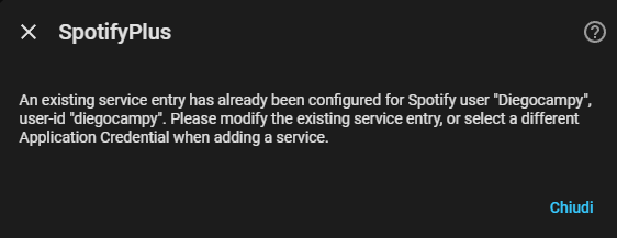

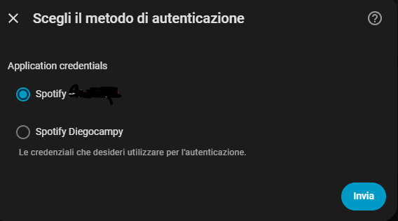

Hi everyone, back again with another issue!
Yesterday, both my Spotify and Spotify Plus integrations (each configured with two accounts) were completely frozen and stopped working. Restarting Home Assistant or reloading the integrations didn’t help. However, when I tried adding a new account in Spotify by simply clicking the Add Account button, this menu popped up:
Then the web authentication process kicked off. I completed it for both accounts, and everything worked fine for Spotify.
However, when I tried doing the exact same thing with Spotify Plus, I ended up getting this error at the end:
What am I doing wrong? Thanks a lot!
