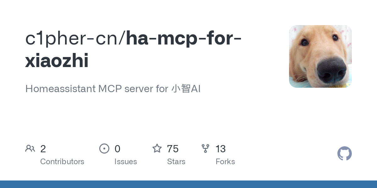

Since both HA and their firmware works on MCP, I wonder if this could be achieved using their firmware and the HA MCP server… Anybody knowing any thoughts about it?
I do not have yet a device could someone test and report?
How did you do this?
yes it works fine (xiaozhi mcp <> HA mcp) :+1:, advantage is your xiaozhi device don’t need vpn, as long as it has wifi it can work from anywhere. with your Home Assistant :slight_smile:

how does it differ from the one from c1pher?
