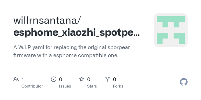

I’d like to share my modifications of the original Ball_v2.yaml from @RealDeco
What it changes:
1 - Adds controls for auto dim (turn on/off) the screen. It lights up upon wake word and dims after N seconds to configurable brightness settings
2 - Adds controls for wake light, using the embeded RGB Led (but separate settings) so it lights up on wake word, fast blinks on “thinking” and slow blinks during response. It just mimics the echo devices behavior for a more polished interaction. The embedded LED goes back to it’s previous setting after the interaction
3 - Least but not last, it integrates the media_player component for future uses as a output speaker for Music Assistant for example. The config file is fully functional, but the full duplex/ media stream DO NOT WORK currently. I’m working with @meconiotech in his absolute amazing full duplex i2s audio driver, so even simple devices like the spotpears in wich mic and speaker share a single i2s bus can have full duplex audio (and the wake word can be always on even with music playing or to interrupt responses). In the future, using his intercom project even drop-in style intercom should be possible.
The file can be found here:
