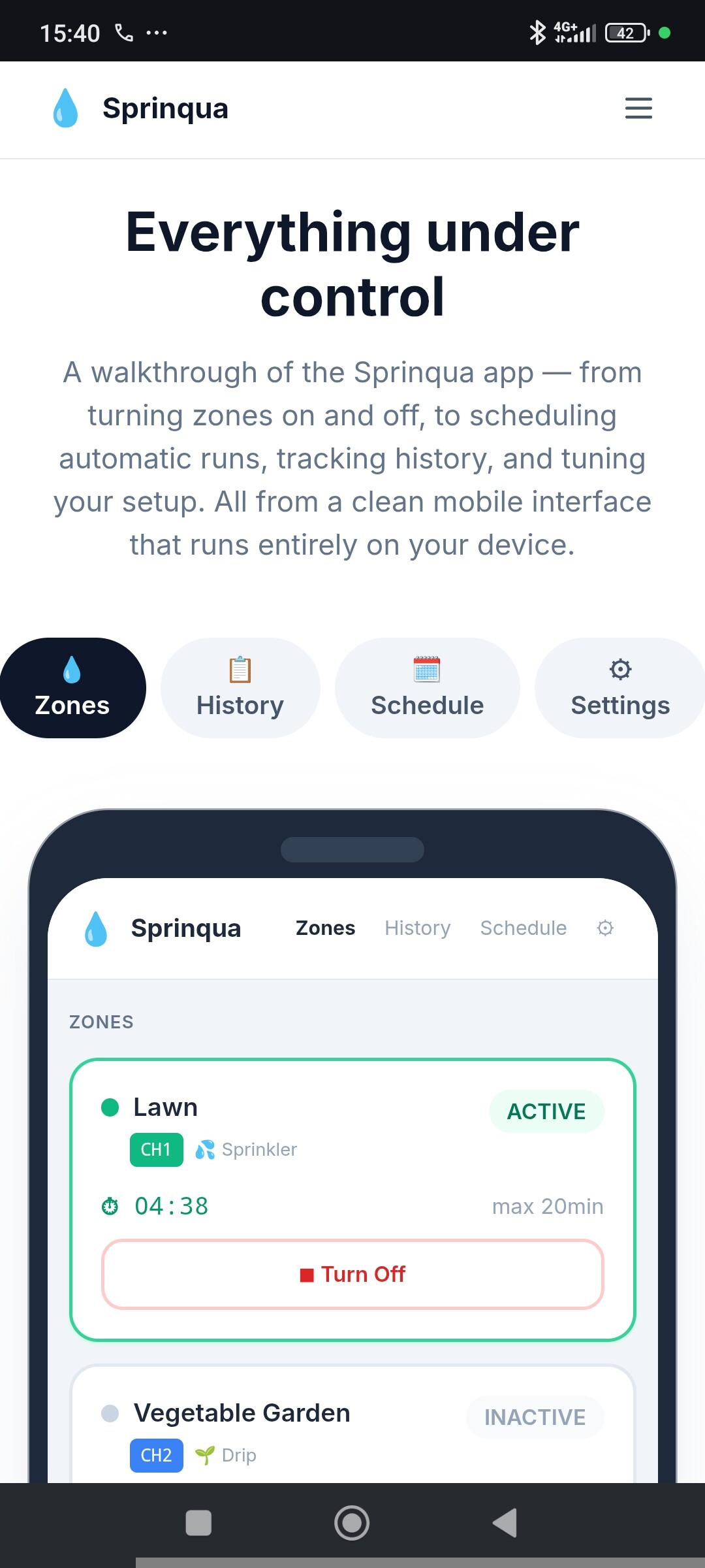

Hey,
I've been building Sprinqua — a self-hosted irrigation controller that runs on Raspberry Pi and integrates with Home Assistant via MQTT auto-discovery.
What it does
  • Zone control — manual on/off, 5-min pulse, or fully scheduled. Safety auto-off per zone
  • Weekly schedules — per-zone day/time/duration with a visual weekly overview chart
  • Smart Watering — integrates with Open-Meteo (free, no API key) to skip irrigation when rain is forecast above your threshold
  • Activation history — full log of every run (manual, scheduled, MQTT, or skipped), 7-day stats and 24h timeline
  • MQTT + HA auto-discovery — all zones appear automatically as switch entities, no manual entity configuration needed
  • Two control modes — Standalone (Sprinqua manages its own schedules) or HA-Managed (HA takes full control via MQTT)
  • 6 languages — EN, PT, ES, FR, DE, IT
Supported hardware
Works out of the box with 8+ relay HATs for Raspberry Pi
  • Waveshare 3/6/8-ch
  • Keyestudio 4-ch
  • Seengreat 3/4/8-ch
  • BC Robotics 4-ch.
A setup wizard handles GPIO mapping and lets you pulse-test each relay before committing.

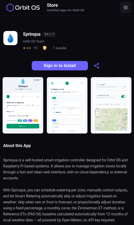

Sprinqua runs on Orbit OS — an embedded Linux platform for Raspberry Pi. Install takes about 5 minutes: install Orbit OS, sign into the app store, install Sprinqua with one click, run the hardware wizard, done.
