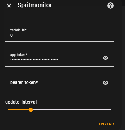

After restarting HA, go to “Settings” → “Devices & Services” → “Add Integration”, search for “Spritmonitor”, and enter your Spritmonitor Vehicle ID, Application-ID, and Bearer Token (you’ll need to obtain these from Spritmonitor’s API).

Hi, thanks for the comment. I’m actually using the public token I found in your post. But during the integration, the startup form requests both the application token and the user-generated one. In any case, I’m waiting for @Spritmonitor response.
Usually you don’t need to contact the Team “spritmonitor.de”, the App-Token is public and the Bearer you can create by your own within your account.
How to:
Log in to your account / (or go to “your account”) → Click on “Change Password” → and below you should see the option “create new token”
This will be your Bearer Token. :slight_smile:
Yes, thank you. That’s what I did following your post. The integration currently generates the sensors in Spanish; I’m working on the translations. Regards

Great, thank you! Perhaps you could also hard code the app token into the script and don’t have the users enter it. I think this would make the configuration even easier and the app token will never change in the future.
Best regards
Team Spritmonitor
Ok, I’ll take your suggestion, take advantage and ask you, how long do you think I can refresh the API without affecting them? @Spritmonitor

I think a refresh cycle of 1 or 2 hours should be ok.
Thank you. I implemented a new form where the token is pre-filled, but I allow the option to change it, and a refresh time range of 1 to 24 hours. Thanks for the response. @Spritmonitor
