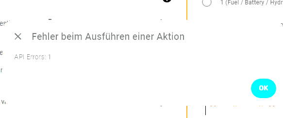

Since I already had an automation where I get all the necessary infos to my phone, I added a new action to it and tried it out. However, I receive the attached error (API Errors: 1) without any clear indication of what it is related to.
All other errors I generated before that were clearly described and were easy to troubleshoot. Here is the code snippet I am trying to run.
action: spritmonitor.add_fueling
  tank_id: "2"
  date: "{{ now().date() }}"
  odometer: "{{ states('sensor.robs_leon_odometer_2') | float | round(0) }}"
  quantity: >-
    {{ states('input_number.stromverbrauch_letzter_ladevorgang') | float |
    round(2) }}
  type: full
  fuelsort_id: "19"
  quantity_unit_id: "5"
  note: NoW
  attributes_tires: wintertires
  attributes_driving_style: normal
  attributes_heating: true
  vehicle_device: *REMOVED*
  trip: "22"
Is anyone able to help me with that?
Thanks!
Best regards,
RoB
You need define the latitude and longitude.
A bug in integration make this mandatory.
Thanks!
Working fine now!
Cheers,
RoB
