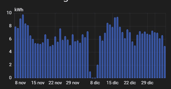

I have a Shelly Em that records consumption from the meter, but it’s been down for a few days, and I’ve got some gaps in the graphs.
So I was thinking of manually entering this missing data.

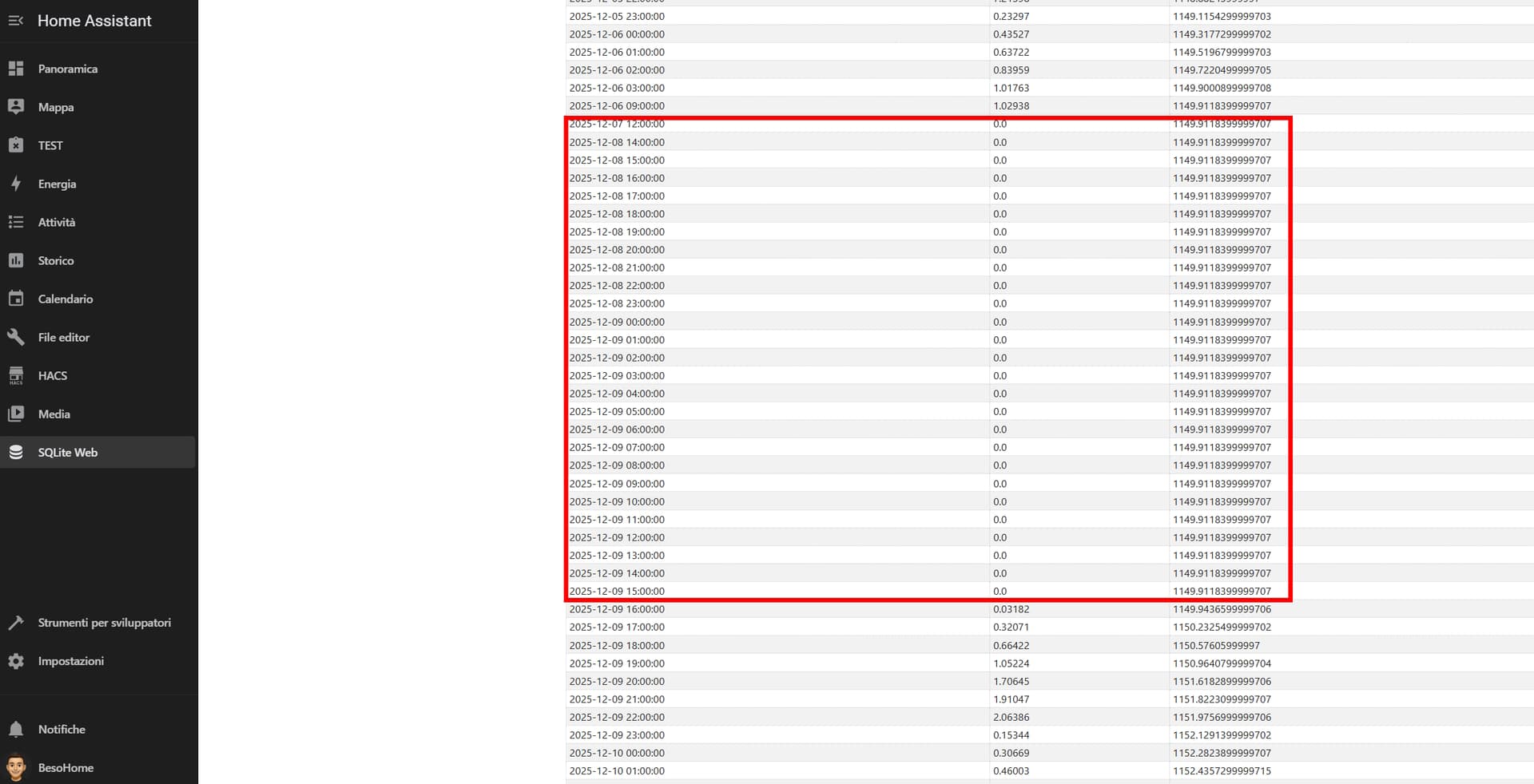

So I was thinking of using this command:
Set the value for the December 8 record
UPDATE statistics
SET state = 7.1, sum = sum + 7.1
WHERE metadata_id = 15 AND start_ts = strftime('%s','2025-12-08 12:00:00');
Move forward all records after December 8th to today
UPDATE statistics
SET sum = sum + 7.1
WHERE metadata_id = 15 AND start_ts > strftime('%s','2025-12-08 12:00:00');
