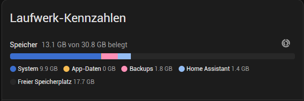

Hello everyone,
I’ve noticed a strange phenomenon: when I run a “du -h | sort -h” command in HA, I get the following response:
319.6M ./usr
481.3M ./var
1.4G ./homeassistant
1.8G ./backup
4.0G .
Now, when I run a backup in Proxmox VM with the VM paused, this backup has reached 13.59GB in the meantime.
06/09: 6.69GB
13/09: 10.32GB
20/09: 12.96GB
The storage usage is increasing week by week.
The backup on 06/09 was carried out following a fresh installation for precisely this reason, with the data subsequently restored.
Where is this hard drive/SSD storage usage coming from and, more importantly, how can I reduce it again?

2. Why the Proxmox backup grows every week
This is probably the main reason, and it has little to do with space usage within HA. When HAOS deletes a file – for example, yesterday’s HA backup (your /backup directory was modified at 00:01 today, so daily backups are running) – the blocks are only freed up for the file system. The virtual disk in Proxmox is unaware of this as long as no TRIM/Discard is passed through. New data is then written to blocks that are still unused, and vzdump backs up all blocks that have ever been written to. The image thus slowly fills up towards 32 GB, even though only 13 GB are actually in use.
Solution:
Proxmox → VM → Hardware → Hard Disk → Edit → Advanced: Enable Discard (it’s also advisable to enable ‘SSD emulation’).
Shut down the VM completely and restart it. A reboot from HA is not sufficient.
On the HAOS host (see below for access details), run a single trim command:
fstrim -av
Afterwards, the next Proxmox backup should be significantly smaller, roughly the size of the data actually in use.
