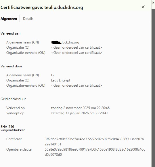

When surfing to the page, take a screenshot of the error + check if there is a button to click that says something of the kind 'more information ’
Edit: if you post a screenshot, obfuscate your URL

Yes, the red icon specifies that it can not trust the SSL cert. Click on it and check what the error messages are.
Dangerous site
Attackers on the site you tried to visit could trick you…
