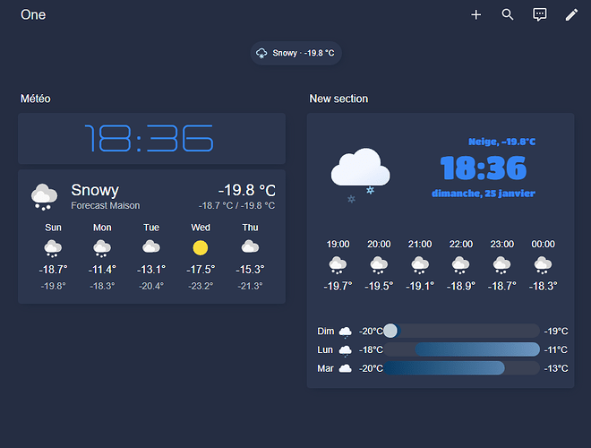

I installed “core-2026.1.3” yesterday and started to see an error box instead of the card.

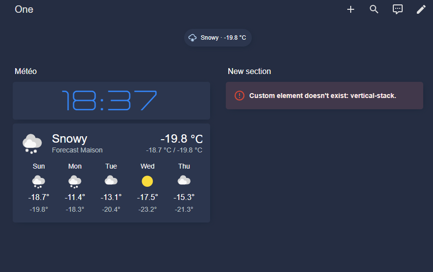

Custom element doesn't exist: vertical-stack.
Now, this error is not always present.

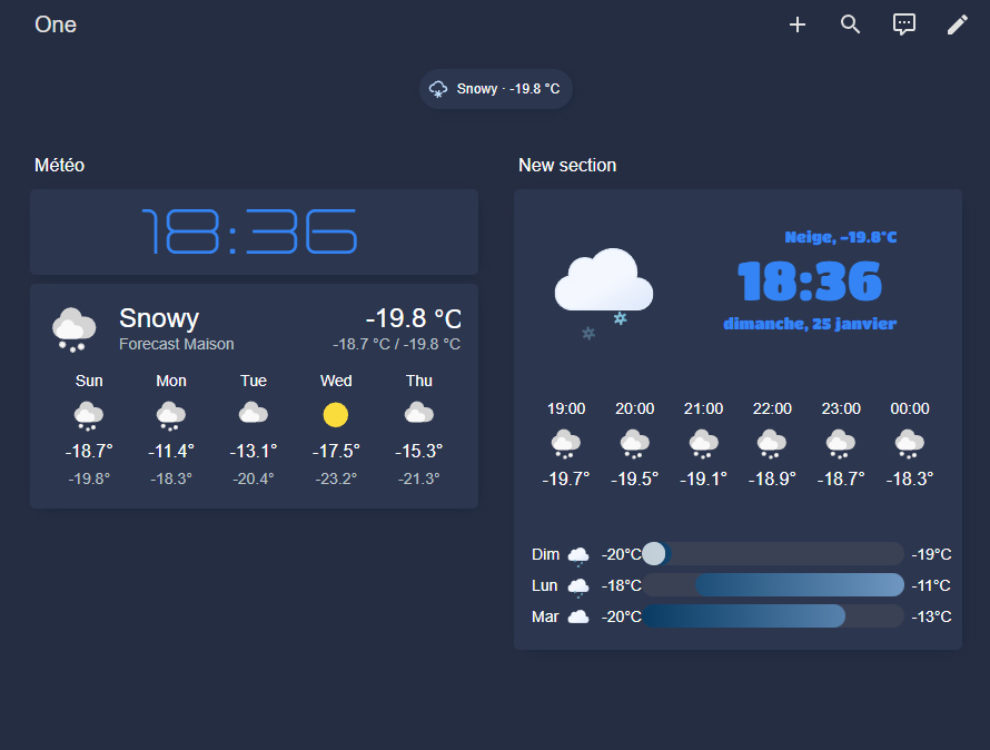

What I mean by that is: if the error is present and I move to another page, like settings or HACS or another dashboard, and return to the dashboard with the stack-in-card mod, the card is shown correctly (no error). I’m not sure what triggers the error, but at some point I just refreshed the browser and the error showed up.
I’m also using the ios HA companion app on an iPad mini to view the customized dashboard and it shows the same error, but only when I start up the app. If the error is shown, I move to another page, like settings, and when I return to the dashboard, the card is shown correctly.

Problem clears when I go to another page and back on both the web page and ios app.
The error message specifically say vertical-stack even if I’m using stack-in-card. But, on the same dashboard, I have a Vertical-stack card and a Stack-in-card card. Could this be the issue?

I still have the same error, which is corrected when I navigate to other pages.

A refresh of the page returns the error.
The error specifies vertical-stack.
