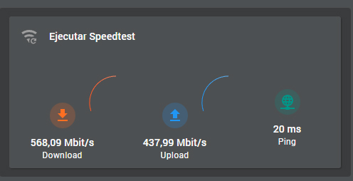

Stack-in-card misaligned
“Is there any way to fix it so it doesn’t look so off‑center? Thanks in advance.

To start, what is this card for?
It is a card where I display the Speedtest values.
The card above that does that. The mushroom template card has no entities and seems to be acting as filler
We need to use a grid layout for what you want.
I’ve been experimenting with different layouts, but so far I haven’t managed to get the radialBar charts centered the way I want. I understand that using a grid layout might be the right approach, but I don’t know exactly how to configure it so the circles stay centered above the text. Right now I’m just testing without results.
