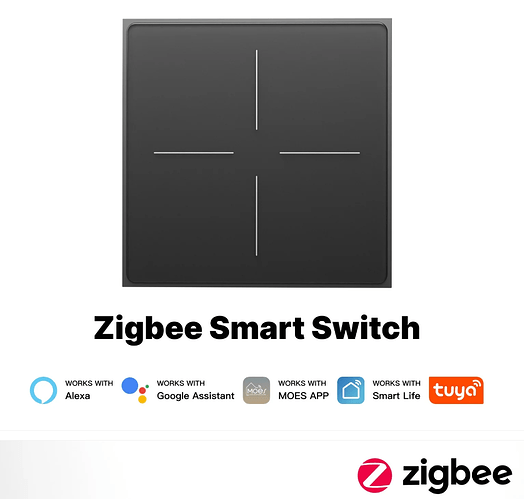

I am thinking of buying these switches for my house (all 4 kinds, 1-gang to 4-gang) and i would like to know if they are compatible to HA. Their purpose is for example the 4-gang switch to control 4 different light sources. Is also that possible? It would be really helpful for me to have an answer since the house is not built yet but the electrical channels are being made now and i have to decide what to do fast. Because I have to order a patch just to show the electrician to see if he can and how to do the proper wiring.
This is the link of the product “**
That’s a picture, not a link. We need a model number to be able to answer your question.

here is the link https://moeshouse.com/products/star-featherg-series-zigbee-smart-switch-push-button-with-neutral-light-scene-2in1-switch-eu-version?variant=50387896828219
Doesn’t look like it’s supported in ZHA, and the closest match I could find in Zigbee2MQTT is a different model (SFL02-Z-4)
