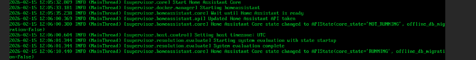

this morning my hassio proxmox stopped working
I have mode no changes the last months or so. I make daily backups in proxmox, but neither these backups are starting.
My hassio core stops here:
tried ha core repair, restarting from older proxmox backups gives same error
I have no idea what i did wrong

Please don’t post pictures of text. Especially unreadable tiny ones.
Post the text.
i cannot copy from the console in proxmox
Are you running the Entso-e integration by any chance? Lots of posts this week about it blocking HA startup.

yes, i am. Already managed to boot in safe mode, and disabled it, and i seem te be getting back into it

Thanks all. I was about to throw the towel and start all over again. I also found out that the backup key i saved was wrong, so this was a useful endeavor.
back online,
but how can a custom component, without being updated or any other modifications on a running HA system, break a running system?

Interdependencies that were not anticipated.
