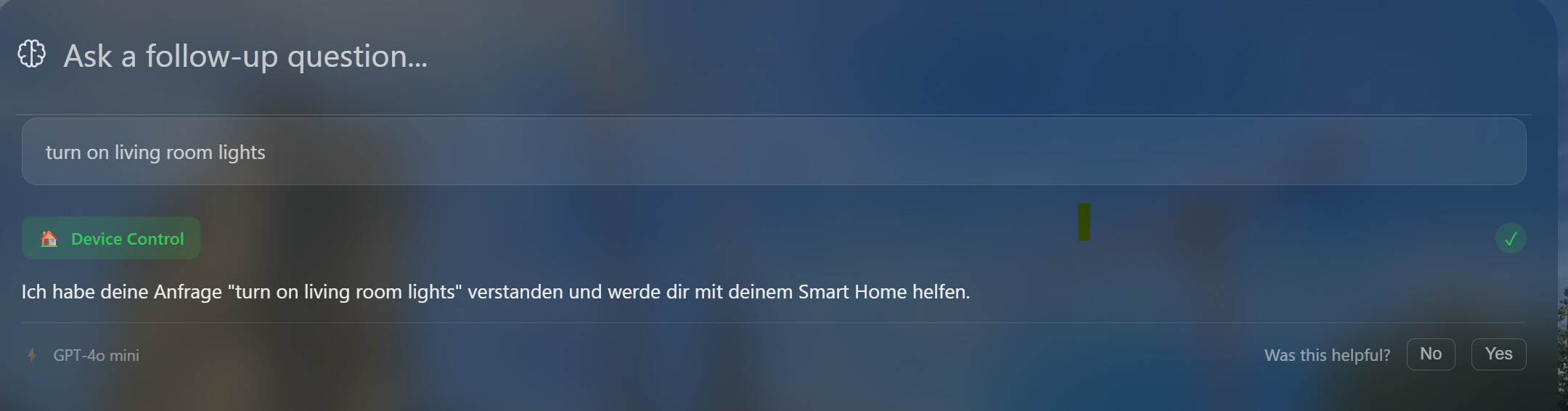

@fastender random question .. the search bar itself can it be hooked into Chat GPT or Claude to perform actions or interpret requests ?
I tried a simple request and i got some response but it was a bit generic and didn’t actually do anything
and oddly cant ask a follow up question
Its on the roadmap (actually only mockup).
Well im here for it bro
