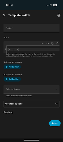

Another question for anyone that might know. I have seen a different method to create template switches is through the UI and not the configuration yaml.
You go settings>devices & services>helpers>create helper>template>switch
I’ve not been able to figure out how to get this to work. For the example I’ve provided for the harmony remote, can anyone guide me through how you configure a switch this way? The home assistant documents don’t explain this at all and only explain the configuration yaml method.
You just transcribe the values from the YAML config into the fields that match their keys… So what your config shows after state: goes in the “State” field, and what follows name: goes in “Name”… You use the “Add action” selectors in their respective areas to recreate the list of action objects that follow turn_on and turn_off.
The “Select device” and “Advanced options” fields are optional.
Keeping in mind that single line state: templates do not need to be quoted if using the UI. So just copy this from your yaml:
{{ is_state_attr('remote.harmony', 'current_activity', 'Watch TV') }}
Thanks I can see where I was going wrong with this method. I was selecting a device and an action for the device to turn on and off, but now that I know the yaml configuration I can see I was supposed to select the remote turn off/on command and target the harmony remote. Got it working this way also now. Thanks for your help.
Just for a bit more understanding, if you use the UI templating method instead of modifying the configuration yaml, where would this code be reflected in home assistant? I thought it would end up in configuration yaml like the more manual method, as automations end up in their own automations yaml
It’s in a hidden file because it’s not meant to be user-modified.
