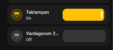

@Hellis81 what theme do you recommend?
@Dujith I tried Card Mod but neither me nor AI tools were able to fix the issue with Card Mod.
I use the normal theme but dark.
The theme you have is probably some kind of low contrast theme.
@Hellis81 You’re right, the problem doesn’t occur when I use a dark theme. However, in this particular case I prefer using a light theme.
By the way, I also tried the Mushroom card, and it has exactly the same issue.
It may seem like a simple issue at first, but it’s actually more complicated than it appears.
Not really, just find another theme that is light but with more contrast.
Or change this theme to get more contrast.
