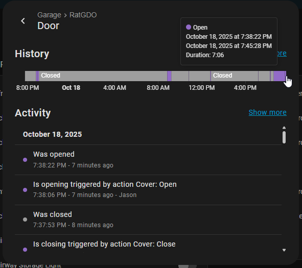

I’m having a lot of inconsistencies after upgrading from an embarrassingly old version of your blueprint (1.4) and can’t wrap my head around whats wrong:

I’m trying to bring up an actionable notification when the gdoor is left open. It doesn’t trigger once the door opens. I had issues earlier with the script not triggering when my user was not Home (Away) but it does work for when a group (Myself and my wife) are both home and away. I’m missing something here. Thanks for the help.
@ytho
Welcome to the community.
Try using ON (option 2) rather than Open in the Start Trigger - State. Even though you see Open in HA it is actually on.
Here is a link to binary sensors and how they work, click here
Also in you action I would select the entity not the device.

Thanks btw! Still no dice though.

EDIT: I was able to make it trigger by using the CLOSED limit sensor being OFF. This is probably the more secure way to run this script since the door could be opened manually and would still trigger. Thank you for the assistance :slight_smile:
