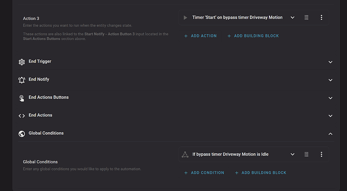

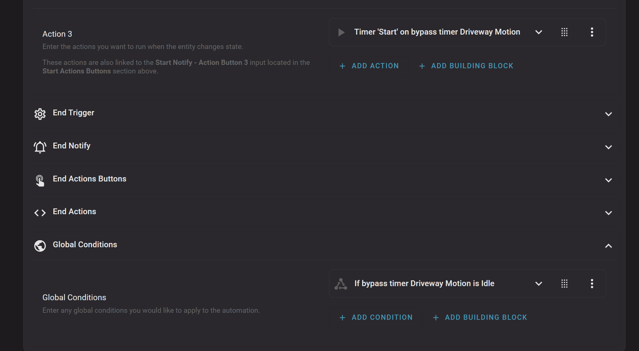

@Blacky I think I found an odd, rare, bug… I suspect something is not updating the Action buttons.
I’ve spent over 2 hours across 2 days testing 6 different automations based on this BP. The automations’ Action buttons should turn on/off these toggle buttons…
Notifications work fine but Action Buttons do not work. And Confirmations do not show, which makes me think the Action buttons are not being activated at all?
What happens… ALL 6 of the automations ONLY change the state of a single Entity, Small Deck (input_boolean.bypass_deck_large_motion)
Even when that entity is not in the BPs code (see example code below). This problem still happens after multiple reboots… and yesterday updating from HAOS 14.2 to 15.0
one of the YAMLs (YES, these action buttons are controlling SMALL DECK, not Driveway)
alias: "Notify Motion : Driveway"
description: ""
use_blueprint:
  path: Blackshome/state-notifications-and-actions.yaml
  input:
    start_trigger_state: "on"
    start_trigger_state_entity:
      - binary_sensor.philips_driveway_motion
    include_start_notify: enable_start_notify_options
    start_notify_device:
      - 4c405513584e73a3a8a3a9996bc35562
      - 3674d1323c5d602efb76a2e00225cbb3
    start_title: " {{ states[trigger.entity_id].attributes.friendly_name }}"
    start_notify_data:
      - channel
      - sticky
      - high_priority
    start_action_button_1: Disable
    include_start_auto_actions: []
    start_action_1:
      - action: input_boolean.turn_off
        metadata: {}
        data: {}
          entity_id: input_boolean.bypass_driveway_motion
    include_start_action_buttons:
      - enable_start_action_button_1
      - enable_start_action_button_2
    start_notify_channel: motion-driveway
    start_action_2:
      - action: input_boolean.turn_on
        metadata: {}
        data: {}
    start_action_button_2: Enable
    start_action_button_confirmation_title: Action...
    start_action_button_confirmation_message: Driveway Motion Notifications Disabled
    start_action_button_2_confirmation_message: Driveway Motion Notifications Enabled
    start_time_delay:
      hours: 0
      minutes: 0
      seconds: 0
    start_message: " "
    global_conditions:
      - condition: state
        state: "off"
      - condition: state
        entity_id: timer.bypass_timer_driveway_motion
        state: idle

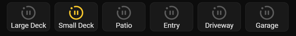

@Blacky is there a diff way to do this… ā€œDo not retrigger for N minutes?ā€
I have some Bosch motion sensors that reset in 30 seconds. I would prefer the automations (notifications) do not re-trigger for 3 minutes.
I tried using a timer but not sure its working. Am I’m missing a better way? If this is not built-in, that would be a fantastic next feature!
thx
@Ltek
The Time Delay functions as a delay ON, but you’re looking for a delay OFF instead.
Why?
You want the motion sensor to trigger instantly, but once triggered, it should stay active for at least 3 minutes after motion stops before detecting motion again.
Some motion sensors have this built-in, but if not, you can create a Template Binary Sensor with a delay_off and use that as the trigger.
It’s best to handle this at the trigger level, rather than within the blueprint.
You will need to add this code below to your configuration file.
I used your motion sensor binary_sensor.sensor_backyard_bosch_motion_deck_s_occupancy and I am assuming it is for your Small Deck but just change the Name and your Motion Sensor ID
template:
  - binary_sensor:
      - name: "Motion Sensor Small Deck"
        state: "{{ is_state('binary_sensor.sensor_backyard_bosch_motion_deck_s_occupancy', 'on') }}"
        delay_off:
          minutes: 3
This is how you add more than one binary sensor to your configuration file. You only use the template: once with your sensor under it.
template:
  - binary_sensor:
        delay_off:
          minutes: 3
  - binary_sensor:
      - name: "Motion Sensor Driveway"
        state: "{{ is_state('binary_sensor.philips_driveway_motion', 'on') }}"
        delay_off:
          minutes: 3
Hope this helps you.
Blacky :grinning:
thx for the help. I’m trying to avoid making Sensor Templates for tons of stuff… seems like the ā€˜workaround’ for so much in HA is to do that but I’d need to create tons of them, and IMO is just not a great solution for most things.
Ultimately I need to have a ā€˜timed bypass’ which I feel is a better for many reasons, more visible, and more flexible solution (a timer can be changes on the fly, and used for multiple purposes). I’m going to try to get this working.
