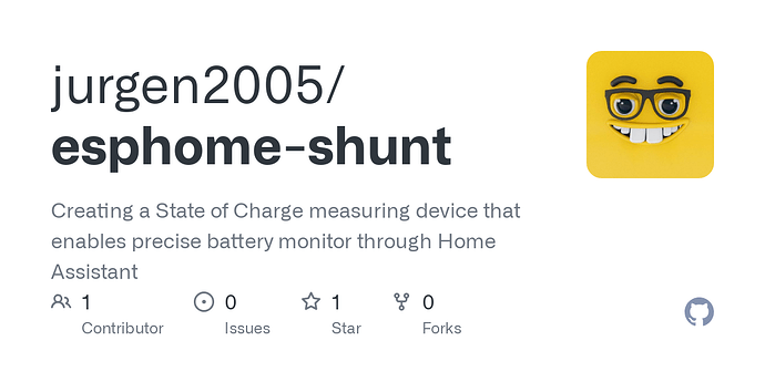

Hi, I am creating a State Of Charge solution that enables monitoring the battery from home assistant. It is all very premature at this moment.
Any comment would be helpful.
More details here:
