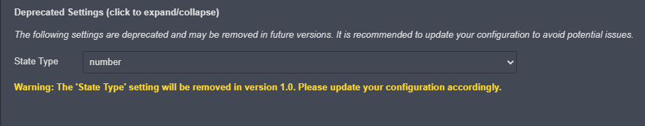

State type is deprecated and will be removed in version 1.0
Yes change it to a string

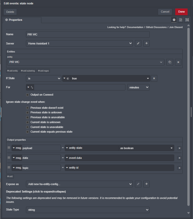

I changed the node to:
But then as the PIR is triggered it is not triggering the next node anymore.
If i change state type to boolean again it is working again.
What do I need to put into the new state node to get the next node triggered again?
“If State” >
is >
you are testing for true. However, this probably does not work since the HA state value will now be the string value “on” or “off” for a motion sensor, so you now have to test for: string as on.
Also:
The output properties >
The entity state >
The as boolean >
should be as Home Assistant boolean
This is a now difference, see notes above. Unless you have a particular reason to, use “as Home Assistant boolean”, not “as boolean”, for the entity state to be cast as before the change.

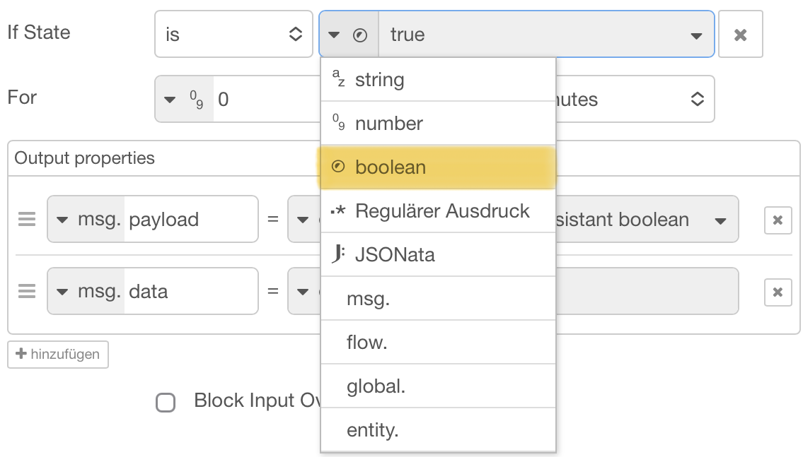

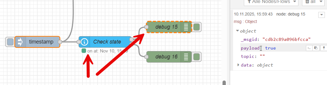

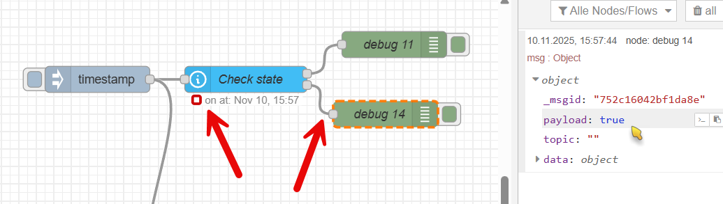

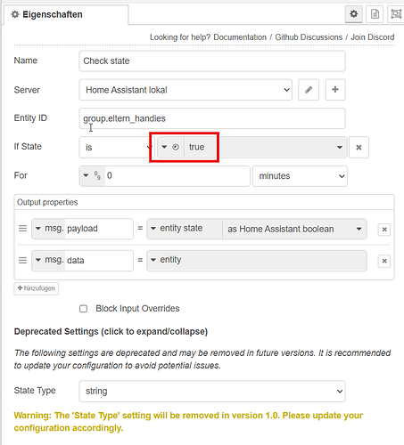

Well, this still let’s me struggle a lot. I have a lot of checks like this with a boolean comparison in the “If State”, and it obviously does not work as expected now:
I would expect that an entity state “on” results in a positive result, but it runs into the wrong path:

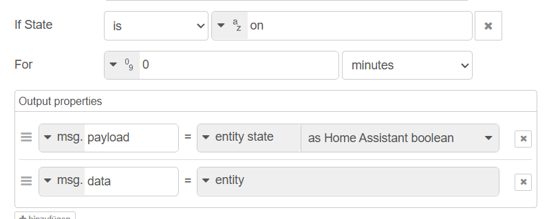

when doing the comparison string-based, it works as expected. But I am hesitant to adjust all my 170 places where i do a boolean comparison :rofl:
Is this a bug or am I missing something?
The node is doing what it should.
The entity state is now a string “on” or “off”
The condition should now be tested against “on” not ‘true’
The only part of the data in the node that is ‘true’ is the output property msg.payload, as the entity state string is only cast to a Boolean value at the very end, using the settings you have.
Ok if this is really the case I have to adjust all the occurrences of Boolean comparisons :pensive:
That more or less means this entry is useless, I thought the mapping from home assistant values would not only affect the output but also the comparison:

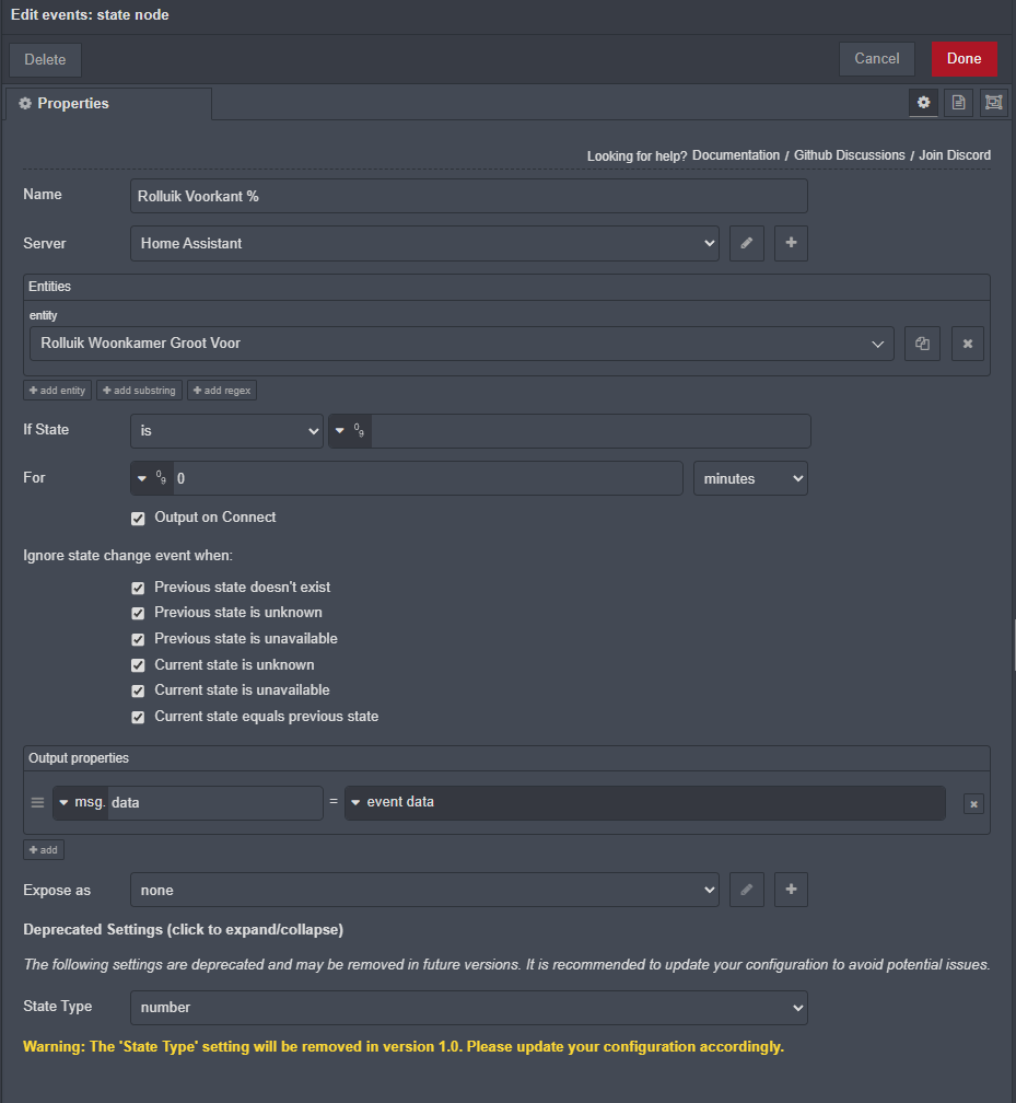

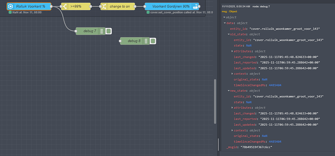

When
I get:
And as soon as I change it to string there’s nothing. I tried a few thing but don’t know what to change when changing the deprecated from string to number…
