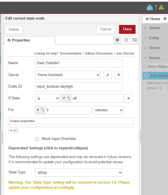

State type is deprecated and will be removed in version 1.0
After checking this again, yes I am sure.

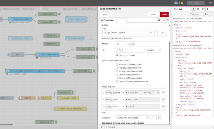

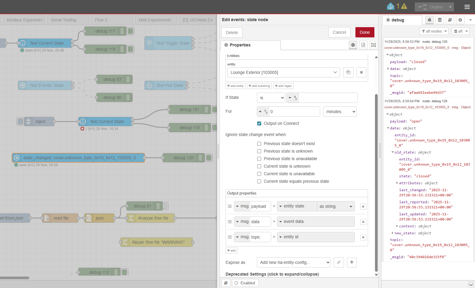

Thanks for another detailed and excellent explanation. Much appreciated! I upgraded to 0.80.3 (for some reason that wasn’t automatically done as part of the Add-On update to 20.2.3 last week), and now my conditional tests using “is” are working as intended.
Mind helping me with this one? This is the reqson I opened this topic…
No-one else???
Dealing with this stuff is impossible on just a phone, and I also needed to update the websocket nodes to the very latest version before doing anything further…
I cannot read the detail in your video - the picture is too small.
As far as I can see, however:
  • You are using the Events: state node.
  • You are using a cover entity.
I have tested this node with a cover entity type, again, and I can find no issue. The cover opens, and I get an event, the cover closes, and I get an event. All working with State Type set to ‘string’.
You may wish to consider:
All covers usually report a state value of “open” and “closed”, or perhaps “opening” / “closing” and “unknown”, which represent either the state of the cover, or the current action of the cover motor. Attempting to cast this to a number is not going to produce a sensible result. The python method returns NaN for strings that do not parse to a valid number. NaN is a value, just as true/false is, and means “Not a Number”, which can be translated to “the string you are attempting to convert to a number is not recognized as a number”. Indeed “closed” has never been noted as a valid number in any civilization on this planet. I can’t speak for other planets.
If you wish to cast the entity state to anything other than a string, then the Home Assistant Boolean set, which includes “open”, will return true or false after casting, and is of much greater use.
In terms of why you are seeing a difference when the State Type is set to “number” or to “string”, I can only assume that you don’t have the latest version. There was a bug in the first releases with the State Type deprecation, and this has now been corrected. As always, as for the most recent post, and as I said almost three weeks ago, and almost without having to say it again, you must always check that you have the latest version of the websocket nodes, particularly after a major change such as this where followup updates may happen for a week or two.
After that, the remaining potential cause relates to the Ignore state change events when: settings.
You appear to be using a cover integration that returns the percentage of cover. This is held within an attribute value. To be clear, the HA event bus will fire an event when any change to an entity state occurs (eg the cover goes from “open” to “closed”) but it will also fire an event on the event bus when any attribute value changed - even if the state value did not change also. This means that, if you run the cover from 40% open to 50% open, you will have an event on the event bus. The state will be “open” in both [or perhaps “closed” in both, depends on the integration] but the attribute value for percentage closed will change from 40 to 50.
In such cases, the settings for the Ignore state changes when are critical. If “Current state equals previous state” is ticked, then opening the cover just a bit will fire an event on the event bus, but it will not be passed on by this node.
You probably need to:
  • update to the very latest WebSocket nodes - 0.80.3 as of this moment in time
  • start with a fresh node, and leave State Type as ‘string’
  • untick your “Ignore state changes when” for “equals previous state” (and probably also for unknown)
  • run the blind fully up and full down
This should generate events at each operation of the blind.
Other than that, I don’t believe I can add any further value here.

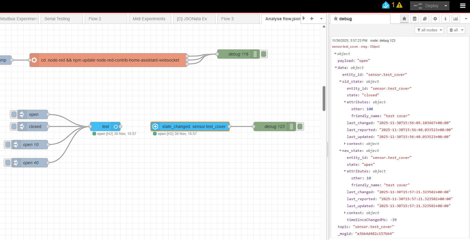

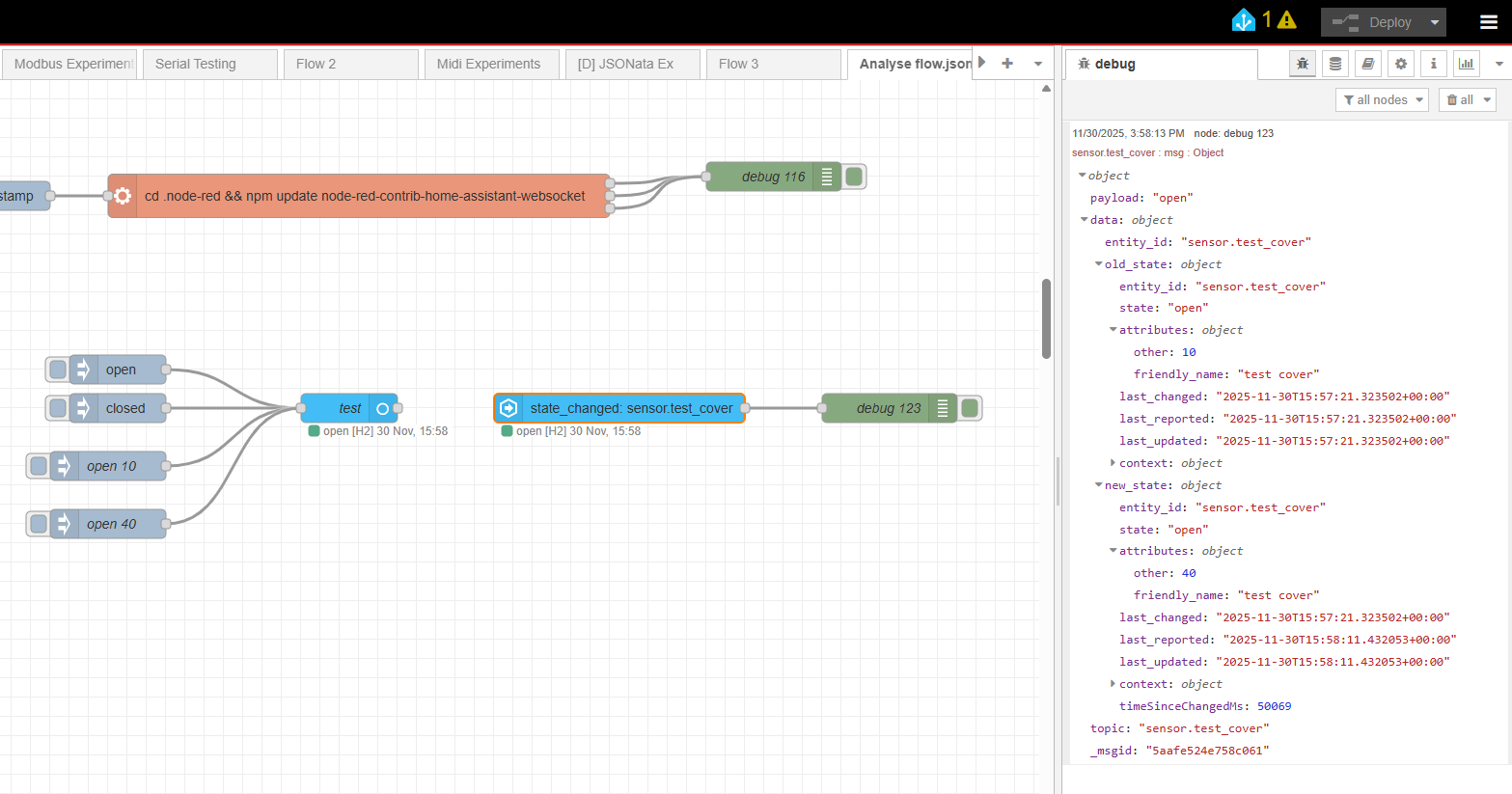

As I said, I have tested a similar Events: state node with a cover entity arrangement and I cannot replicate your issue. What you say is happening for you is not happening for me, and for me it all works as expected.
I suggest that you check the Node-RED logs when you operate your blind, both with the node State Type set to “number” and again with it set to “string”. I also suggest that you check your current versions for HA, the Node-RED add-on, the WebSocket nodes, and for the Node-RED Companion.
You may have had this working for years, but casting a state string value “open” / “closed” to a number has just been generating a state value NaN. You are relying on HA generating a state event just for an attribute change only (which it will) but you have set your node to ignore state change events where the current state equals the previous state, hence the node would never respond to just an attribute change only, so I am unable to understand why it ever worked for you at all.
Sorry, but that is not my issue, I rely on another value from the entity. I could use it before but anyomore. I believe you can not replicate this as you must het similar cover entities on HA then. Do you have them?
I have some cover entities.
One integration generates a state change of the cover state value to “opening” on open [or to “closing” on close], then to “unknown” almost immediately after (it is not able to track the actual state of the cover so reports ‘unknown’).
Another integration generates a state change of the state value to “open” on any open, and to “closed” on fully closed.
Neither integrations have the ability to track percentage opening, which is what you are doing using a state-attribute. So I have set up a mock sensor cover, with both state value and an attribute value, which I can change as either the state value only, or the attribute value only, or both the state value and the attribute value at the same time.
As a mock-test: open cover from ‘closed’ 100% to ‘open’ 10%
Then, change to 40% by changing only the attribute ‘other’.
The Event: state node still fires, even with the state remaining as “open”.
The Event: state node does what it should - it generates an output message for the state event change caused by only the attribute (‘other’) changing from 10 to 40.
You can see that at this event, the fields for
  • last_changed
    • Time the state changed in the state machine in UTC time. This is not updated if only state attributes change
  • last_reported
    • Time the state was written to the state machine in UTC time. This timestamp is updated regardless of any changes to the state or state attributes
  • last_updated
    • Time the state or state attributes changed in the state machine in UTC time. This is not updated if neither state nor state attributes changed
change correctly for the updated (as the state-object has changed) but not for the changed (as the state value has not changed).
All working as expected.

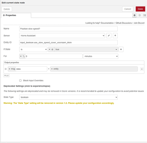

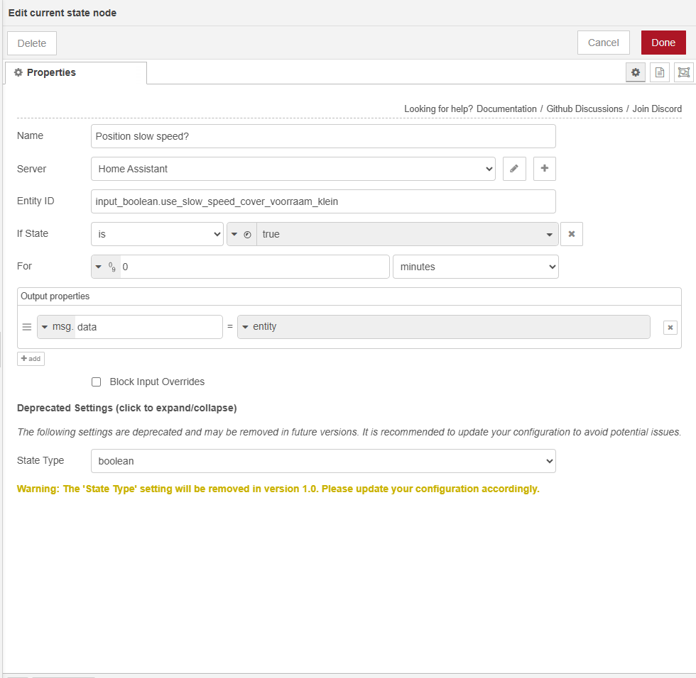

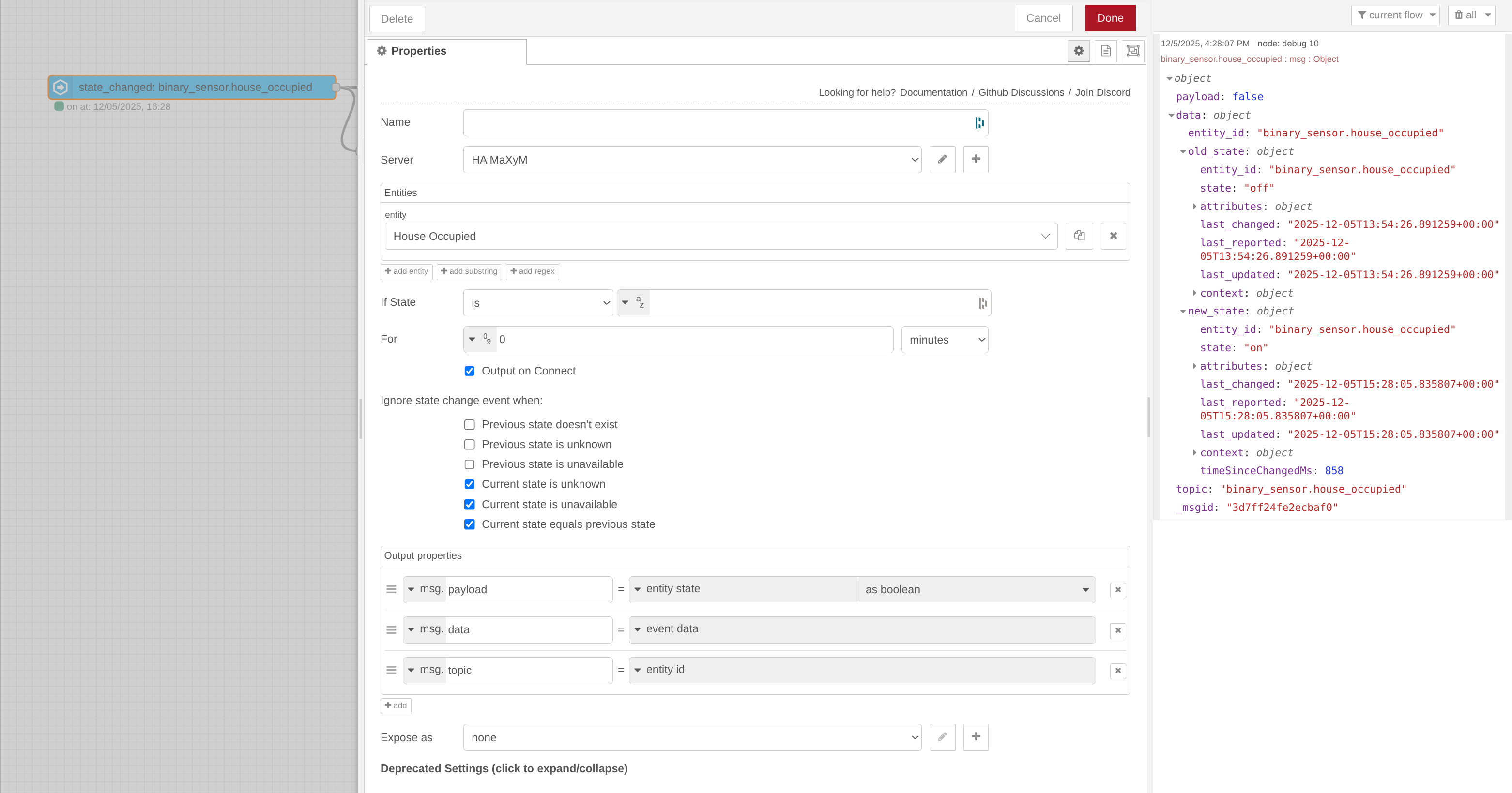

I was thinking I understand what is going on… but… I suppose I’m not.
If you look at screenshot. There is state change node, tracking a binary sensor.
I don’t use a built-in condition feature, but I set entity state to be converted to a boolean before reaching output’s payload.
Then look at debug: data confirms new state is ‘on’. Why was it not converted to true?
Below config of the HA server node.
You need to use as Home Assistant Boolean not as Boolean
There are now two different Boolean castings. as Home Assistant casts using the State Boolean list in the config node. as Boolean uses as standard test against the state string as ‘true’, or a number as not 0 only.
The option ‘boolean’ is new, and performs a casting of the entity state value to boolean using a more traditional procedure.
If the state string holds “True”, then this will be converted to lowercase first, then tested for an exact match to “true”, returning boolean true. The same for “False”.
If the state string holds a number, then this will be converted to a number, with 0 returning false and everything else returning true.
Thank you. For some reason I didn’t noticed Home Assistant Boolean when setting that.

I have also a lot of deprecated items.
But I don’t see what I need to change. Yes at the bottom you could set it to string to hide it. But what is the correct solution:
