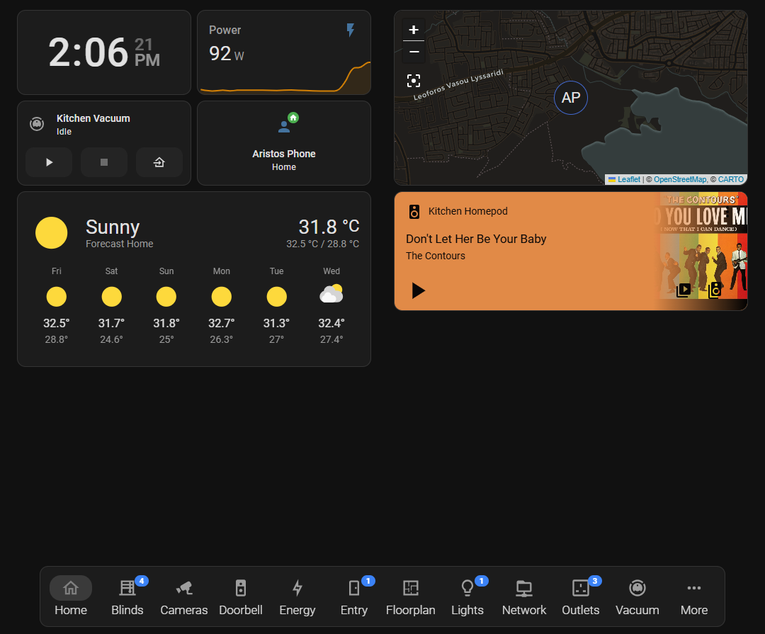

I’ve been using navbar card for some time now, and while it’s great at what it does, it’s getting to be a bit of a paint to maintain across multiple dashboards and pages on multiple home assistant installations. Yes, maybe there are ways to make my life easier, but I don’t have the time to maintain custom code any more.
I’m looking to see if there’s a more “native” way of having such a navigation bar at the bottom of the screen, without needing 3rd party components.

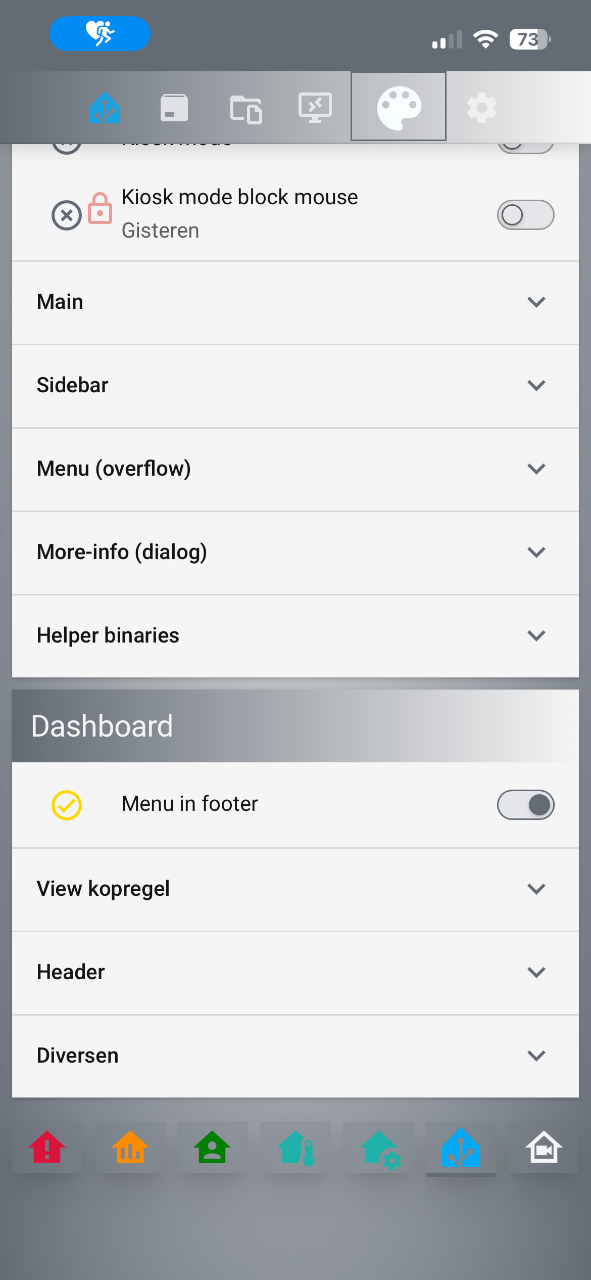

added to that, you can also use a grid with buttons and keep that floating at the bottom of the view with a very simple include on each (section) view
footer:
  card:
    !include /config/dashboard/buttons/buttons_dashboards_footer.yaml
that include is nothing more than
type: vertical-stack
visibility:
  - condition: state
    entity: input_boolean.menu_in_footer
    state: 'on'
cards:
  - !include /config/dashboard/buttons/buttons_dashboards.yaml
in my case, because I want to be able to toggle it on or off
the buttons_dashboards.yaml is a set of carefully crafted custom-buttons, but you could very easily add navigation / shortcut cards in there, and have everything stock Frontend
