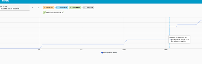

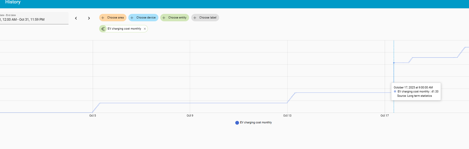

I track my electricity usage and one graph i have is EV charging costs, an errant charge of 25 euro went into the statistics on the 17th which i have since removed and i have purged the recorder but it still shows in my other graphs which pull from long term stats, any ideas?

Are you sure you are not graphing state data instead of LTS?
yes exactly
So that is a graph of the state values not LTS. It will be purged in 10 days if you have not changed the default.
The state values will not affect the energy dashboard once you have fixed the statistics.
Statistics are generated from the state values as they occur, not retroactively. So you have nothing to worry about.
