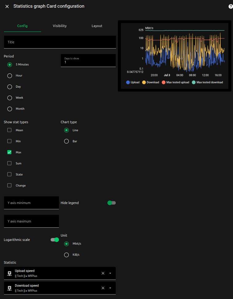

I have a graph for data transferred on my WLAN router and it allows me to select from TWO units only: Mbit/s and KiB/s:
However, such unit option isn’t described in the statistics-graph docs lol
And then, to add insult to the injury, the statistic card has a unit option (described in docs, though), but that’s only for visuals (the UI field is text, not radio or a select box), it does NOT convert the data as the Statistics Graph does :exploding_head:
