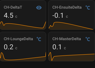

I can use them in Dashboards for small graphing but not Statistical graphing
Look nice but these sensors don’t appear to exist for statistical graphs - Home Assistant just declares these sensors non existent.
