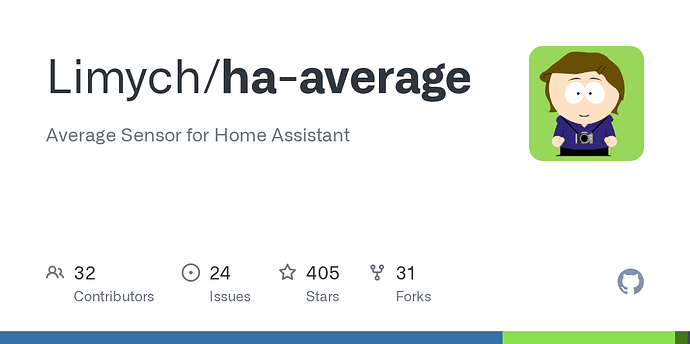

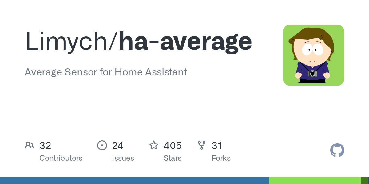

This third party integration can average over a defined period (e.g. current month or last month).
it hasn’t been updated in quite a while but there don’t appear to be any show stopping issues open.
