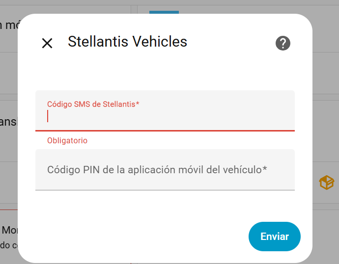

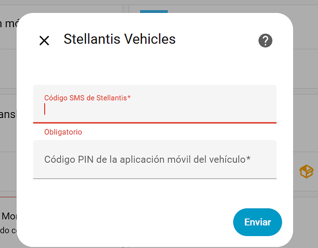

Thanks for this integration. I have succesfully installed but I cannot authenticate because I don’t receive a SMS and I do not have a pin code for the app. In the latest version of the MyOpel app this is not an option in the user accounts settings. Does anyone know how to proceed?
Another question: do you have to have the paid subscription (Connect PLUS) to use all the remote features in HA?

Thanks for this integration. I have succesfully installed but I cannot authenticate because I don’t receive a SMS I have the original pin code for the app.
In the latest version of the MYpeugeot app this is not an option in the user accounts settings. Does anyone know how to proceed?
