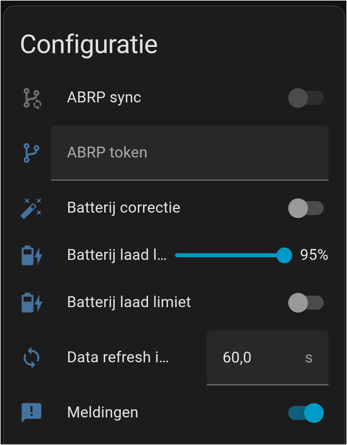

Hello I have HA with the stelantis vehicle working for mij Opel Astra electric i see a lot more than in the Opel connect app nice.
But what can i do with the config?
And the accu SOH keeps 0 ?
