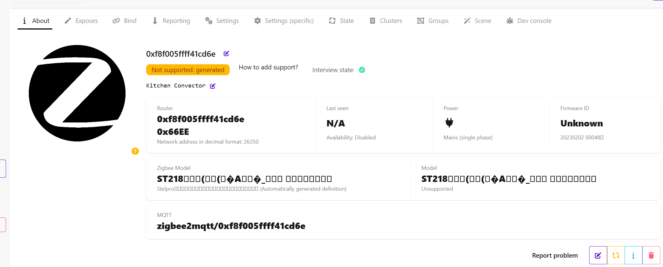

The convector is received and installed. Paired with Zigbee OK but unfortunately the info shows unsuported device.
Any guidance on how to have this recognized as a thermostat would be great.

Forget my last post.
I did re-interviwed the device and the thermostat info appeared so I believe it is now recognized correctly.
