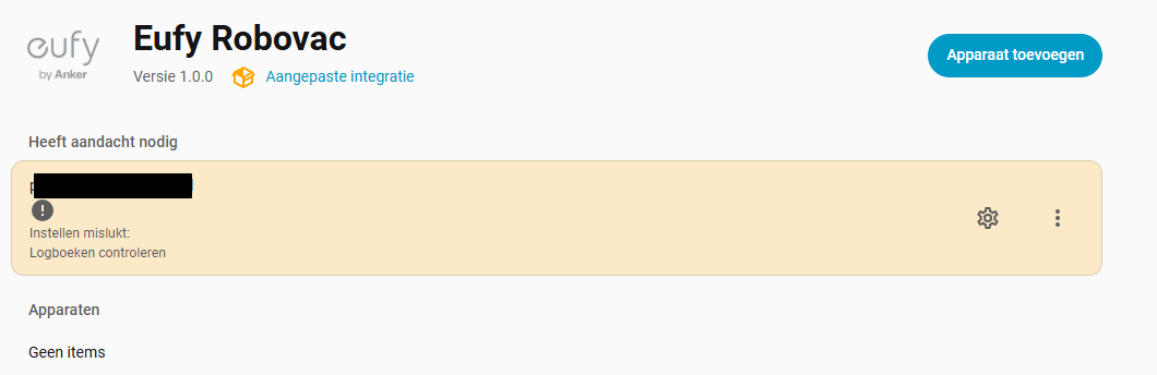

I’m at a loss… I’ve created all the folders through file-browser, uploaded all files to the corresponding folders and restarted HA, yet somehow the battery % remains unavailable and controls in the Vacuum Card do not work.
In my system logs I see the following three errors reported.
Anyone have any ideas how to further troubleshoot?

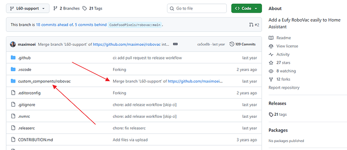

I have the same. tried for hours now and can’t get it right.
Be shure to use the right files and be sure you copied ALL FILES.
If you forget 1 file, even from another eufy model, it will not work.
Here is the link again :
Okay, I think I’ve figured it out. What worked for me was deleting everything first. I started by removing the eufy robovac integration and vacuum card from HACS. Then, I deleted all the robovac files in my custom_components folder.
After that, I put everything back in this order:
  1. First, I reinstalled the eufy robovac integration from HACS and added my vacuum. At this point, I only saw the battery status, which was showing as “unavailable.”
  2. Then, I downloaded and added the vacuum card again.
  3. Lastly, I copied the following folders back to Home Assistant via Samba share:
  • custom_components/robovac
  • custom_components/robovac/translations
  • custom_components/robovac/vacuums
By following this order, I finally got it working. It didn’t work for me to put the files in mannualy via file editor, Shamba share is the way to go.

Tried this @Bromeister-jpg , but it’s not working for me… I cannot even select the cleaner In the vacuum card. Also tried the other , manual option (without hacs) , same result.
It seems to discover the robot more or less, as it does show the IP address matching it, however, end result is just battery showing as “not available”
