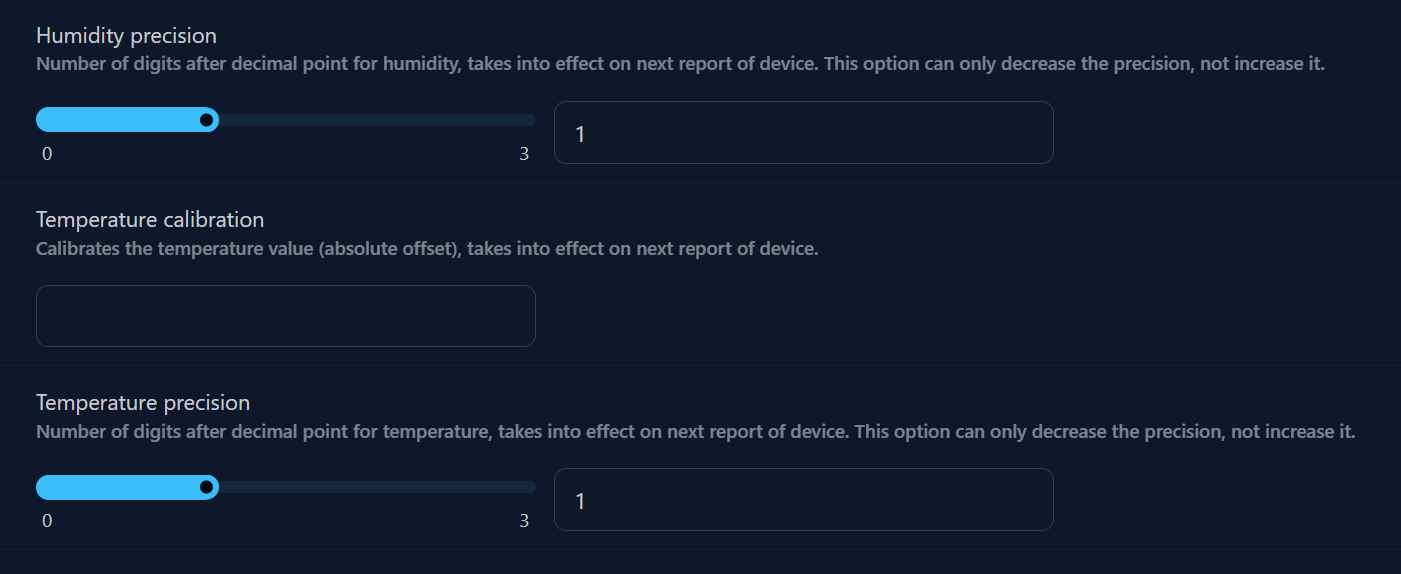

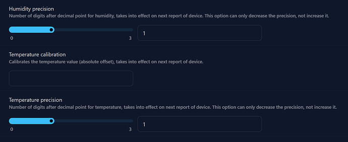

Z2M allows you to set (reduce) the precision on devices. I believe default is 2 dp, which might be more than what ZHA provides by default.

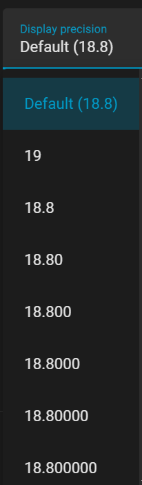

How is that different than what is built into Home Assistant?

HA can only work with the info it receives from the underlying integration and reduce the precision from there. It can’t magically add extra values to those decimal places if the info wasn’t there in the first place.
Assuming the Z2M device sends Temperature as 18.825, you can choose to reduce the value sent to HA as 18.82. You can then choose (inside HA itself) to further reduce it to 18.8. Trying to increase the dp after the original value has been sent will only result in additional zeroes at the end.
What I’m saying is, if ZHA only sends 18.8, you can choose to either display it as 18, 19 or 18.8. Increasing the dp won’t magically cause the “proper” value to be shown - all it’ll do is just add a bunch of zeroes at the end.
Neither integration can do that, hence my emphasis on reduce. It all boils down to the chain between the base device reporting precision to HA:
