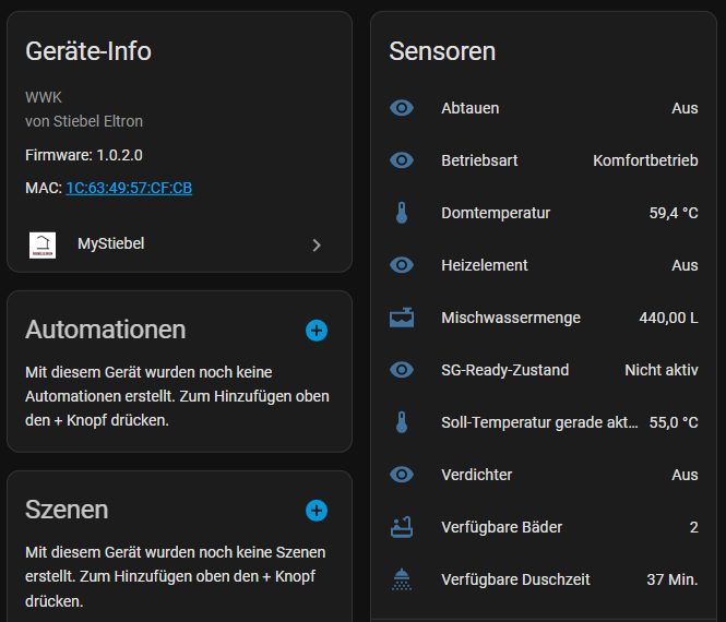

I also spent some time reverse engineering the MyStiebel app. I have since developed a working integration for it as well. Feel free to start testing, I’d love to hear feedback. You can find the integration at: GitHub - sanderkwantes/mystiebel: A Home Assistant integration to monitor and control Stiebel Eltron devices via the MyStiebel cloud service.
Wow, great - thanks for the work. I assume it was a huge amount of effort.
For my WWK-I 300 W Plus it works out of the box:
