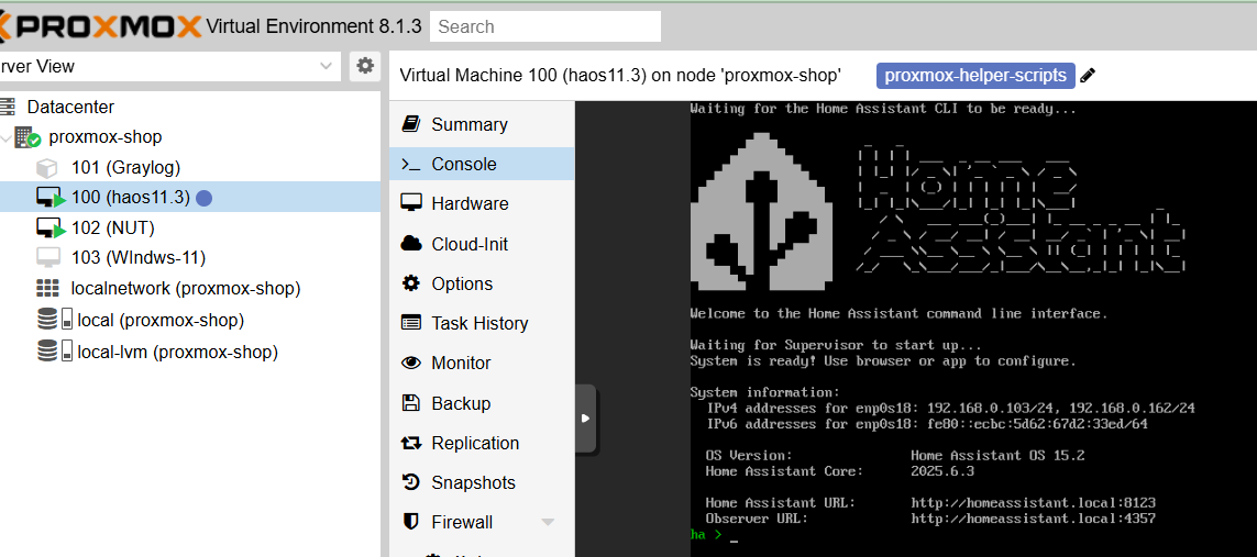

I’ve had an HA instance running in Proxmox for years.
Over the past several days I fought a fierce battle to upgrade core from 2024.10.4 to current and finally (with a lot of help from the people here) succeeded.
It worked until a restart, and now I have no UI access (that is: access locally via a browser pointing to 192.168.0.103:8123). I’ve tried different browsers, as well as the HA app on my cell phone.
I can access the CLI via console in proxmox, as shown below.
And I restarted the VM in proxmox and watched it load – did not see any errors or failures.

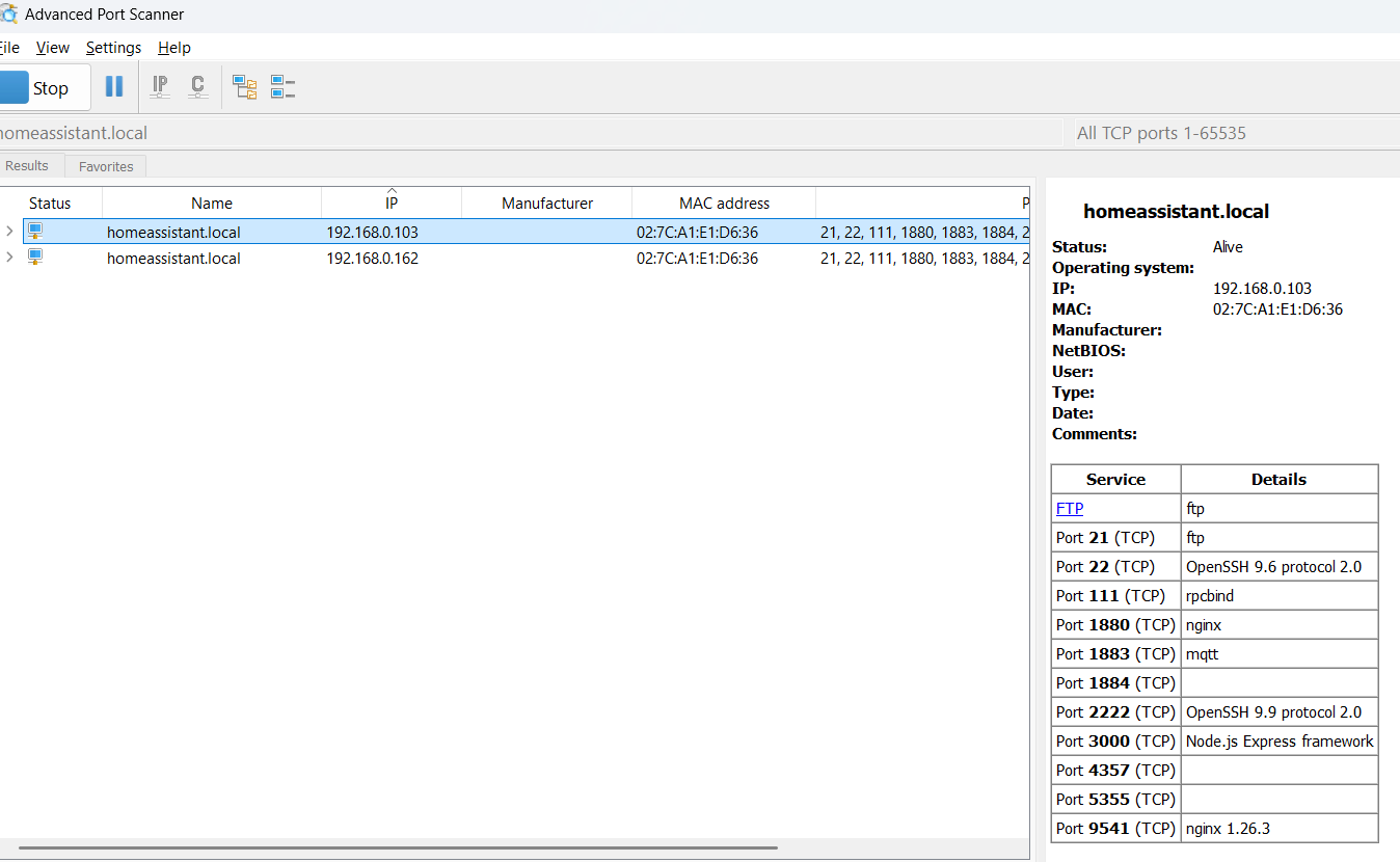

I can ping 192.168.0.103 but running a port scan does not show 8123 open.
Ugh! Please help.

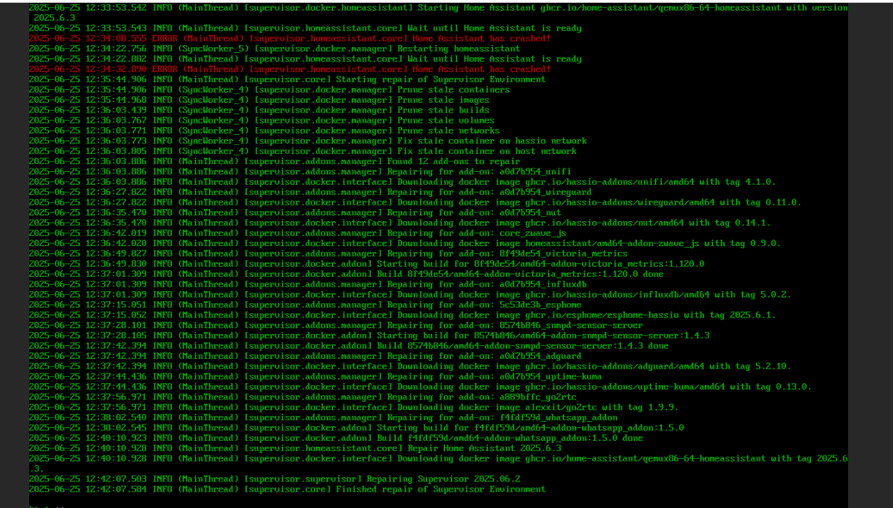

Both commands issued.
“supervisor repair” took about 5 minutes and respond with ‘success’
core rebuild responded with:
“unknown error, see supervisor”
Still no http access or open port 8123

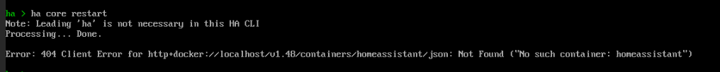

Also issued:
ha core restart --safe-mode
and got the same error (“unknown error, see supervisor”)

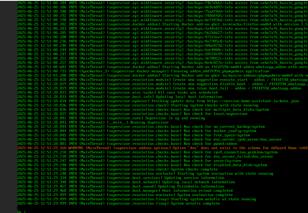

On your proxmox console, just enter
ha supervisor logs
josephny

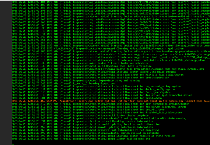

9
Seems plenty of other services are working:

francisp
(Francis)
June 25, 2025, 4:51pm
11
Last lines of your log screenshot shows
So either Supervisor is downloading the docker, or it failed to download the docker

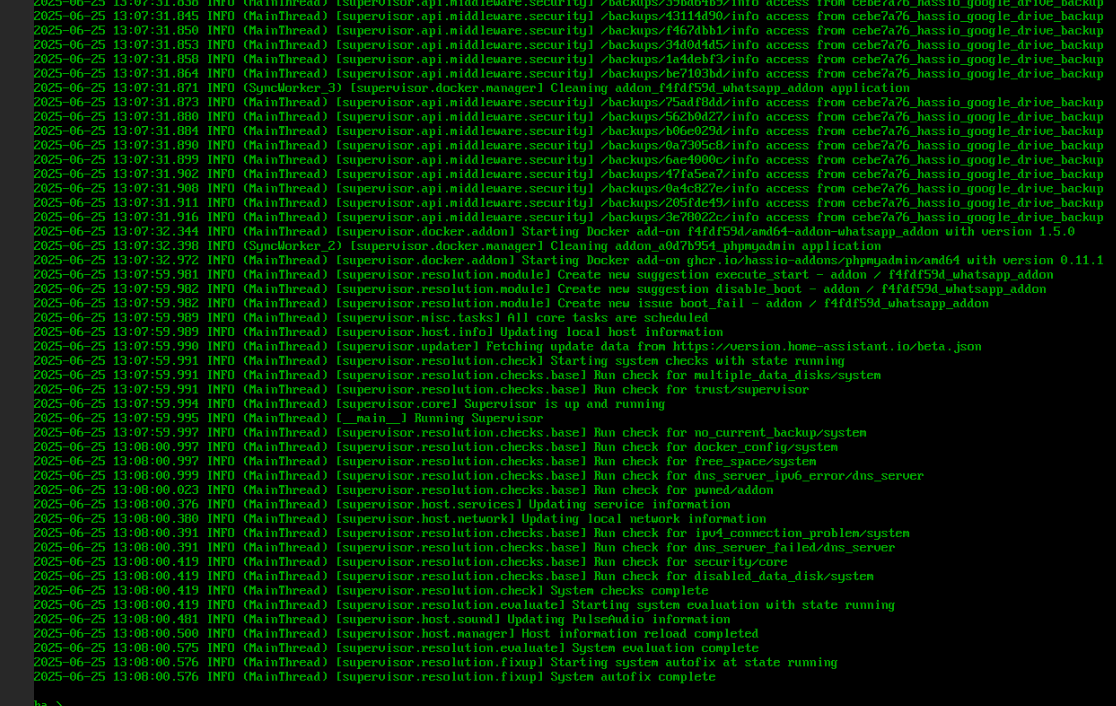

What can I do or check next?
I rebooted the VM again, and ran “supervisor logs” and got the following:

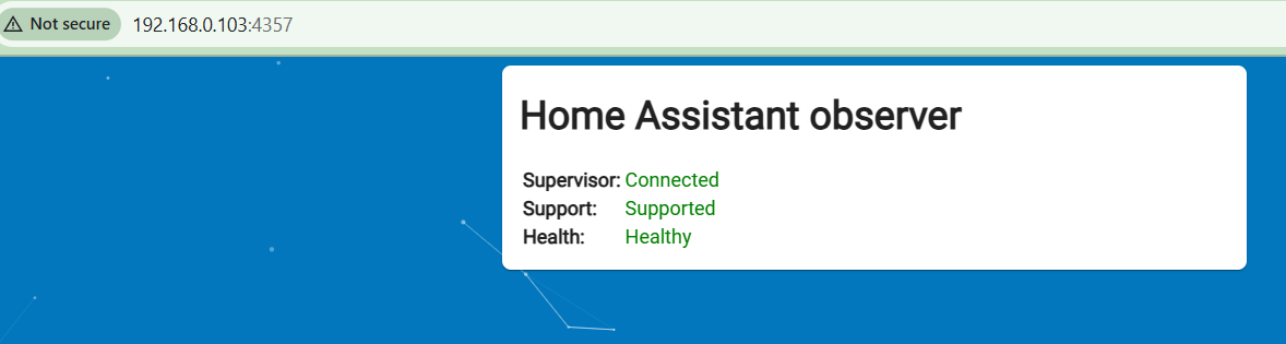

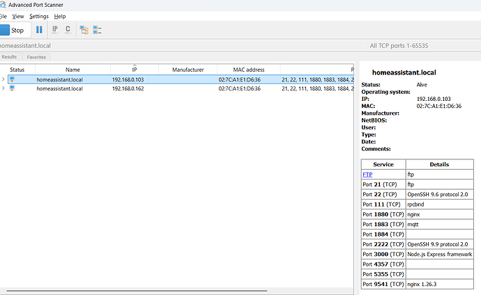

I check port 4357 and it says all is well:

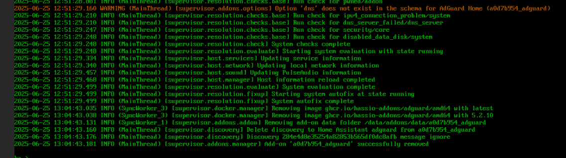

josephny
(Joseph)
June 25, 2025, 5:09pm
15
I uninstalled it, rebooted the VM, and same problem.

Current supervisor logs:

Why wouldn’t 8123 be open?

home assistant container is not running
