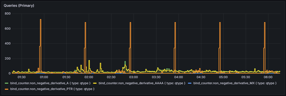

Since installing HA a few years ago, every hourly interval it is performing roughly 1,000+ PTR lookups to the primary local nameserver (my LAN is a /22) for every IPv4 address on the subnet, illustrated here:
How do I go about stopping this behaviour? As far as I’m aware it was doing this since fresh installation so I don’t believe it’s an extension/addon but I might be wrong on that.

I’m not concerned about the actual hitting of the BIND9 nameservers I run, they don’t care, it’s only 1000 PTR requests in a short burst and forward and reverse addressing is fully configured for the LAN on v4 and v6. That’s not the issue. I just don’t have any need for this behaviour. Everything in HA is configured, there is no discovery or scanning or hosts required.

I’m not suggesting it’s hurting anything, it’s just “distorting” my stats charts :slight_smile:
