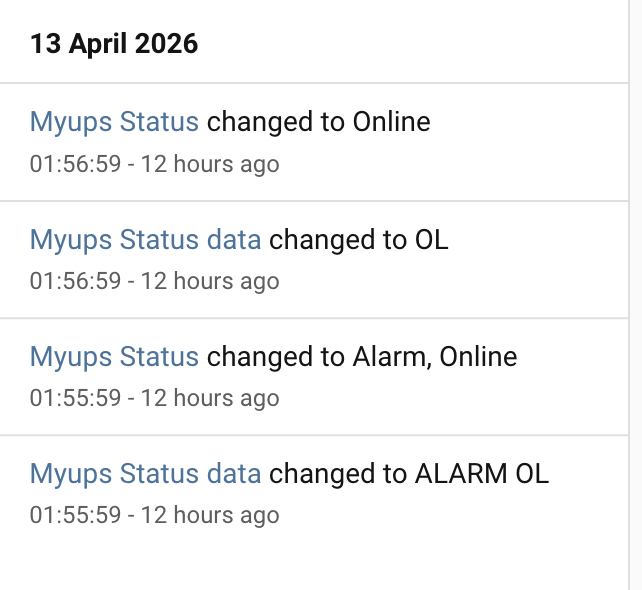

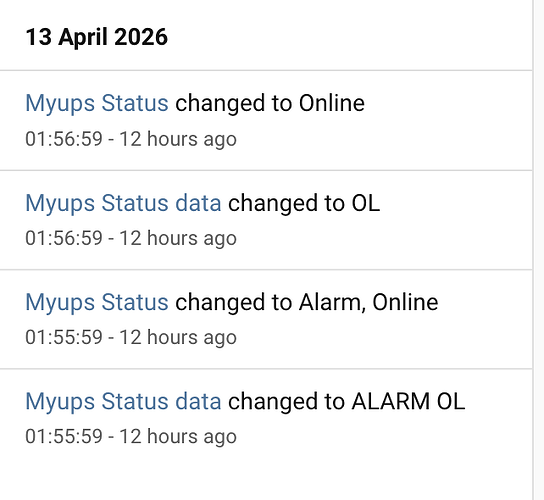

From the HA integration, you can see it flips from one state and back pretty quick…

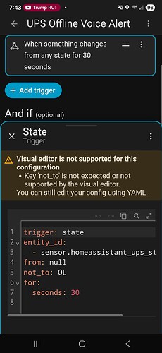

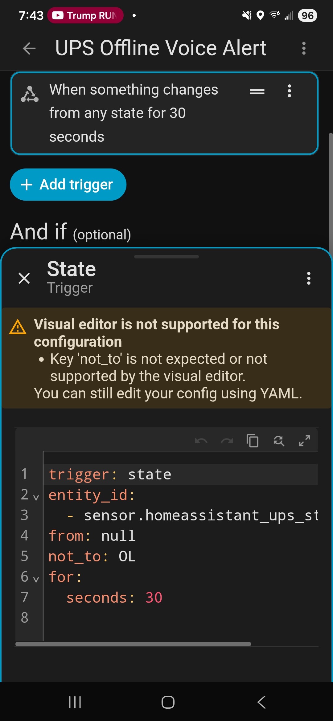

In automation there is a changes to for (time) concept
Don’t know why yours is flipping like that but you can absolutely make - and it stays that way for a few seconds before I trigger. Part of yihr trigger. Just change the automation to include the timeout

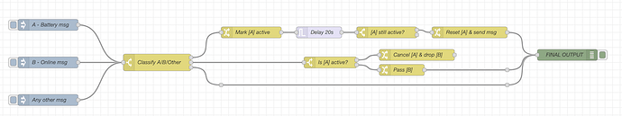

I don’t like being beaten by a task so I put some more time into it and have come up with this slightly more complex flow and it doesn’t have the constant delay of your flow caused by the join…
I think both are pretty cool options and better than the function node.
