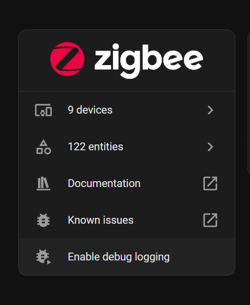

Start by checking your configuration.yaml file for entries named logger. Default is warning, so anything with a lower log level will cause more log entries.
If you can’t find anything there, start looking in your integrations. Each one should have an option which starts debug logging. If you see Disable debug logging, then you’re currently running the logs for that integration in debug mode.
Finally, assuming you’re on 2025.9 or above, if you still can’t find what’s using the 16GB you can use storage insights to narrow it down.
