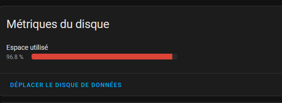

Good morning,
I had to re-install my HA from a backup because my disk had reached 100%.
But after not even a day, I have 90% (450 GB) of the storage used, I really don’t understand who is doing this.
Thanks for the help.

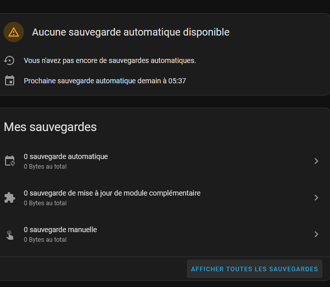

My backups are sent to my NAS server
Maybe, but still check the size of your backup directory.
backups are created locally then moved. Back in the day (6 months ago), they were local only.
I just disconnected my backup NAS storage and deleted all local backups, but the disk remains full.

Because no folder is large, there is just something that consumes space little by little without knowing what it can be.
SO,
I tried reinstalling with just my add-ons installed (AdGuard and NGNIX).
I confirmed that the issue still exists.
Looking at the AG files, I deleted the logs and statistics and the magic 1% disk usage.
So I reduced the giving from 30 days to 24 hours, but that wasn’t enough.
This morning I was at 74% while last night I was much lower.
I can also confirm that it is only the logs that are taking up space, that by deleting the statistics today, I have gained nothing.
So it’s weird that there isn’t a configuration in GB and not in days for the logs.
And I also find it strange that logs take up several GB.
That means adguard is spamming it’s logs. Look at the logs and see what it’s complaining about. Then fix the problem
