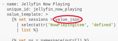

What kind of sensor is your example?
It employs the value_json variable which is supported by REST, MQTT, and Command Line.
Is it the RESTful integration?
If it is then it presents a challenge because it doesn’t support defining custom attributes. Its json_attributes option is limited to extracting keys, and their values, directly from value_json (no templating).

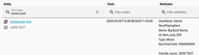

To simulate your Jellyfin server, I created an HTTP endpoint (in Node-Red) that, when queried, replied with the JSON payload you posted above.
Then I created the following REST Sensor.
- platform: rest
  resource: http://localhost:1880/endpoint/hello
  value_template: "{{ now().isoformat() }}"
  json_attributes_path: "$[0]"
  json_attributes:
    - UserName
    - NowPlayingItem

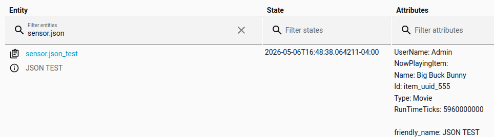

Upon reloading, the sensor successfully reported the desired information.
Specific attributes can be extracted as follows:
{{ state_attr('sensor.json_test', 'UserName') }}
{{ state_attr('sensor.json_test', 'NowPlayingItem').Name }}
Based on those results, your sensor configuration can look something like this:

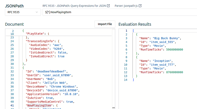

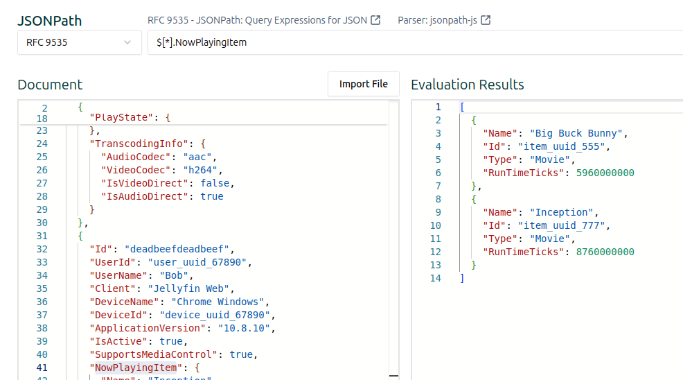

Based on tests using JSONpath.com, this should work.
However, when I try $[*] in a REST Sensor, it only returns information for the first item in the list (just like with $[0]).
      json_attributes_path: "$[*]"
      json_attributes:
        - UserName
        - NowPlayingItem
Unfortunately, it seems like it's a deadend.

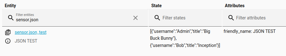

It appears you will need to use the sensor's state to hold the desired information (like you originally planned). The state can only hold a maximum of 255 characters so let's hope the desired information from all of your Jellyfin sessions never exceeds that limit (otherwise it will be truncated).
Example
- platform: rest
  value_template: >
    {% set ns = namespace(items=[]) %}
    {% for i in value_json %}
      {% set ns.items = ns.items + [dict(username=i.UserName, title=i.NowPlayingItem.Name)] %}
    {% endfor %}
    {{ ns.items | to_json }}

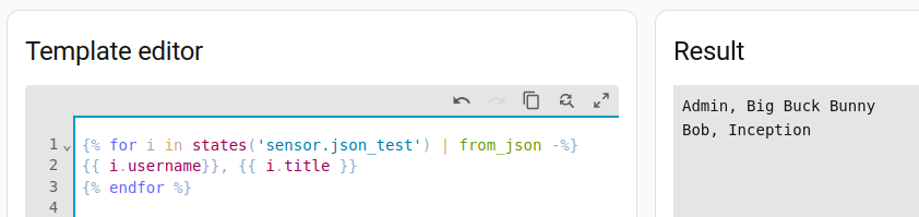

I can iterate through the sensor's state value like this:

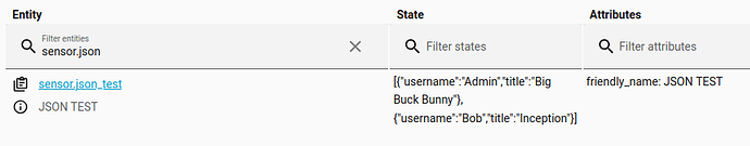

Ty so much for your time and help on this. The state solution seems to work ok with up to about four concurrent users before it is in danger of being truncated ,which is enough for my use case.
To make more room for additional sessions, we can abbreviate the key names from username and title to simply u and t.
  value_template: >
      {% set ns.items = ns.items + [dict(u=i.UserName, t=i.NowPlayingItem.Name)] %}
    {% endfor %}
