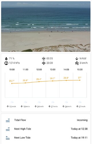

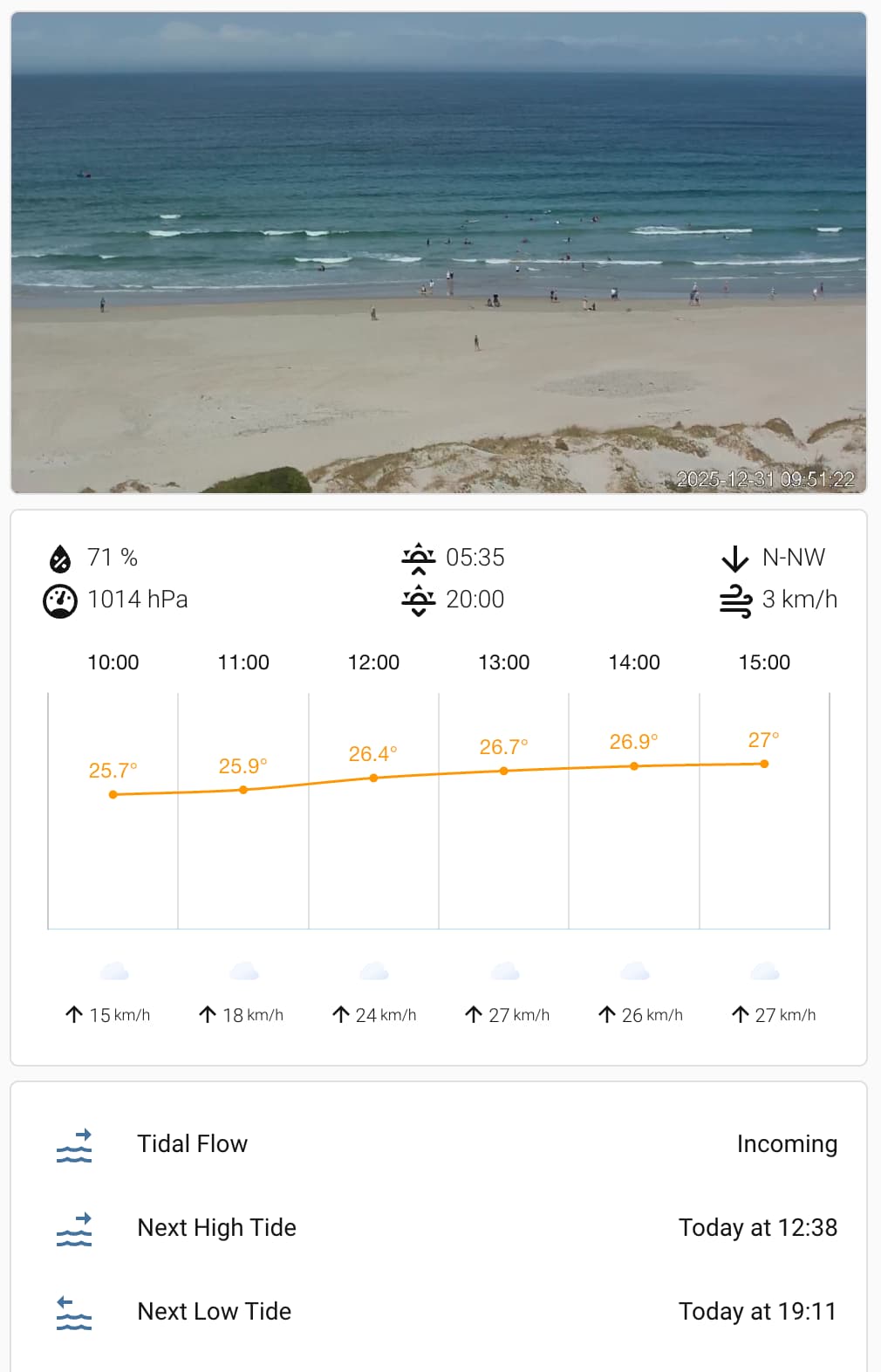

Because I’m pedantic, I want to show the tide order for the next low and high in chronological order. Unfortunately, that was quite tricky to achieve. I considered other options, but in the end settled for this using the template entity row mod. I also wanted to display the times in a particular format.

Why did I do this? We stay 20km from the nearest beach and I wanted a way to know when it would be a good time to go for a swim with the family.
