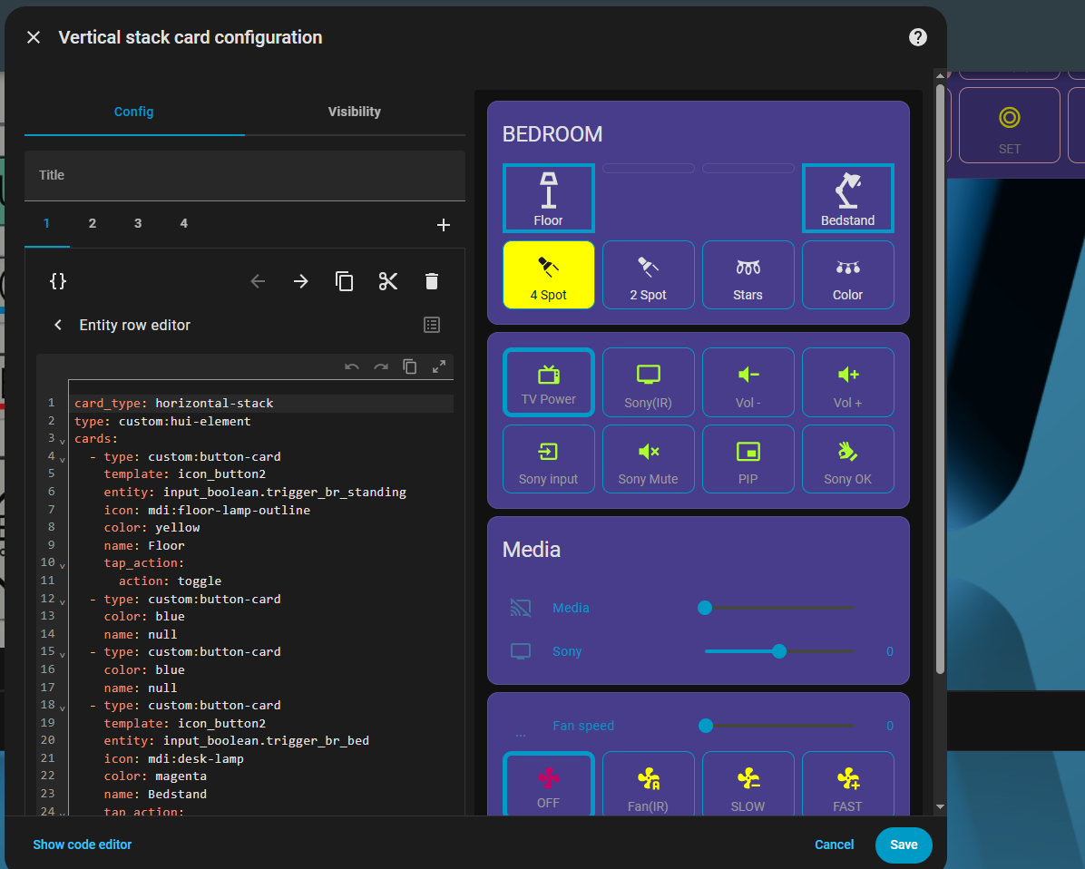

When I click the button, the action is called correctly.

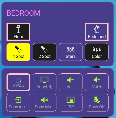

When the entity input_boolean.trigger_br_standing is ON, it gets the color yellow (as specified)
The first time the entity goes OFF, the button color changes to black
Then ON again for yellow
The second time the entity goes OFF, the button colow changes to the color of the card (which is set through card_mod style to darkslateblue)
What am I missing? Why does the button OFF color change every time i switch OFF
And if I have the dashboard open on another device (phone, PC) then the color of the button on that device may be different from the first device, but it also changes every time the entity goes OFF.

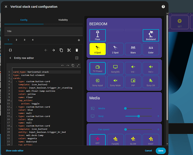

I have noticed that while working on the buttons in the code-editor, when the left side of the window is the text editor and the right side of that window is a preview.
The preview works correct (I mean as I expect it to work, entity ON yellow, entity OFF color of the panel that the button is on.
Floor and Bedstand are both OFF
4 Spot is ON, 2Spot is OFF, Stars is OFF
