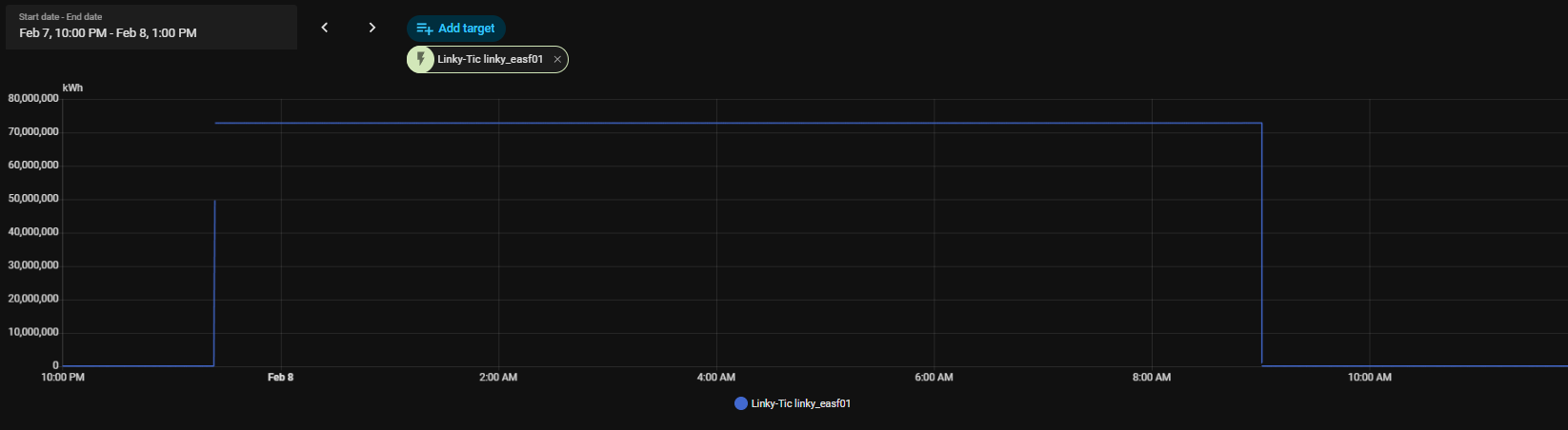

We can see that at 09:00:35 (time of reboot), the sensor became unavailable and, then inexplicably, its unit of measurement reverted to kWh. And at 09:00:36, the sensor becomes available again and reverted back to recording the values in kWh, even though the integration continues to provide the data in Wh ???
I don’t understand why Home Assistant, when it receives information from a sensor in Wh, decides on its own to convert this data into kWh. What is this decision based on?
Now, if I look at the statistics_short_term table, it continues to behave as if nothing has changed. It continues, like the states table, to record information with the wrong old unit of measurement ???
