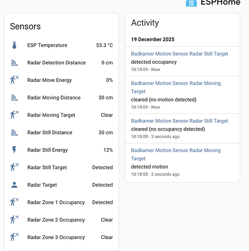

Looking at the LD2410C in HA shows like this, only strage thing for me is that it still shows activity while no one is in the bathroom or even near it. Might that be the problem?
Now the sensor is in the ceiling above the bathroom under the attic. So, I had a mice problem at the attic, could that messed up things? I’m not sure if there are still some mice around inbetween the ceiling and attic floor. Caught 6 or 7 of them :slight_smile: did not see any activity of them last week.
How to troubleshoot this behaviour and not working of the automations? Your advises please. Thanks

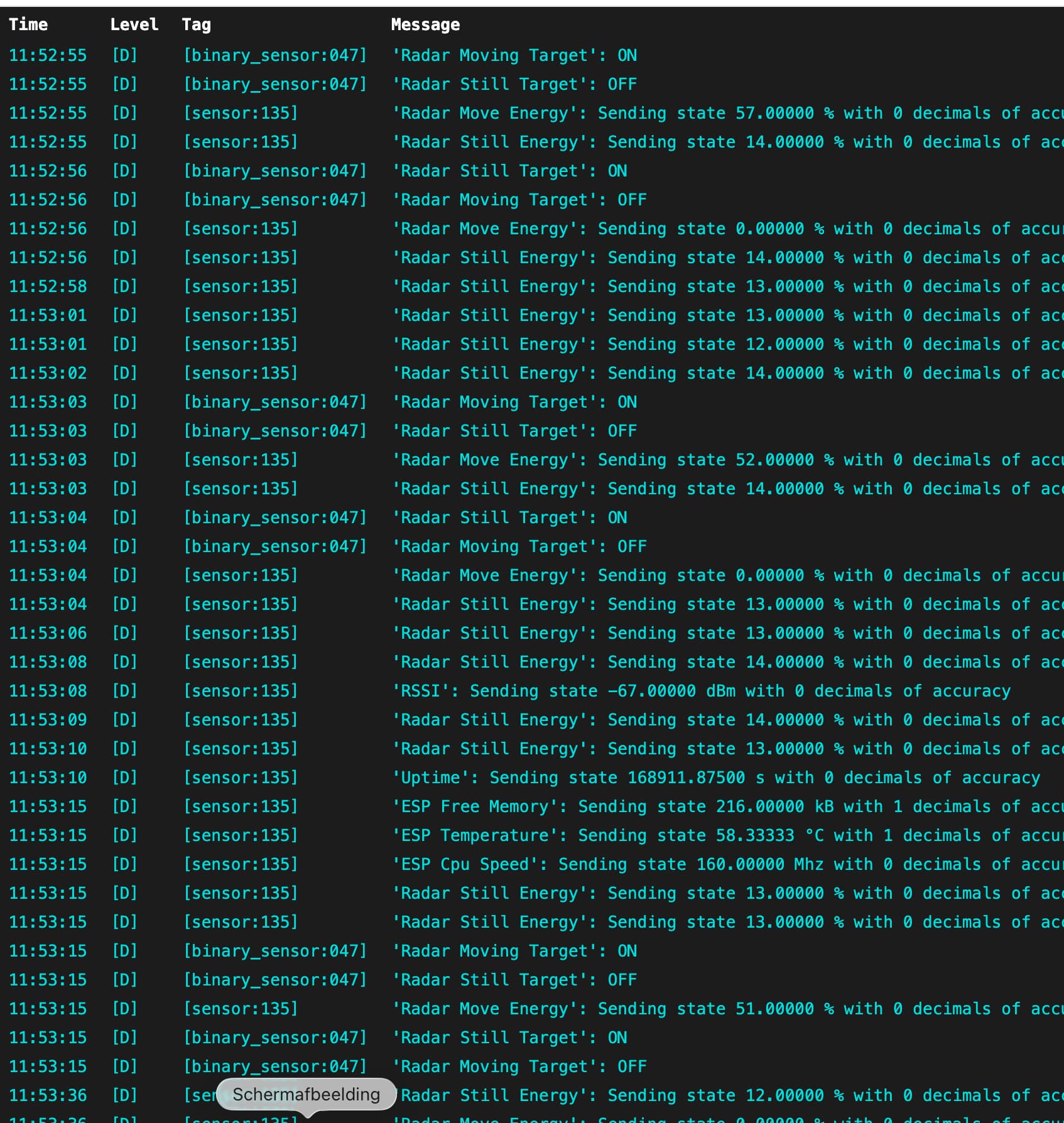

Start with esphome logs.
Had a look at that (esphome) nothing strange or error there. In the esp_device the log looks like this, only strange thing for me is that it is switching between radar moving and still many times. Bt might be normal behaviour. I’m not very well know with this.
`Radar Moving Target’: ON
11:53:03 [D] [binary_sensor:047]
‘Radar Still Target’: OFF`

Anyway, post your sensor configuration YAML and the logs using code tags (not a screenshot).
Did you make changes to the code? What esphome version?
It seems working again. I took the power of for a short period. Think that helped.
