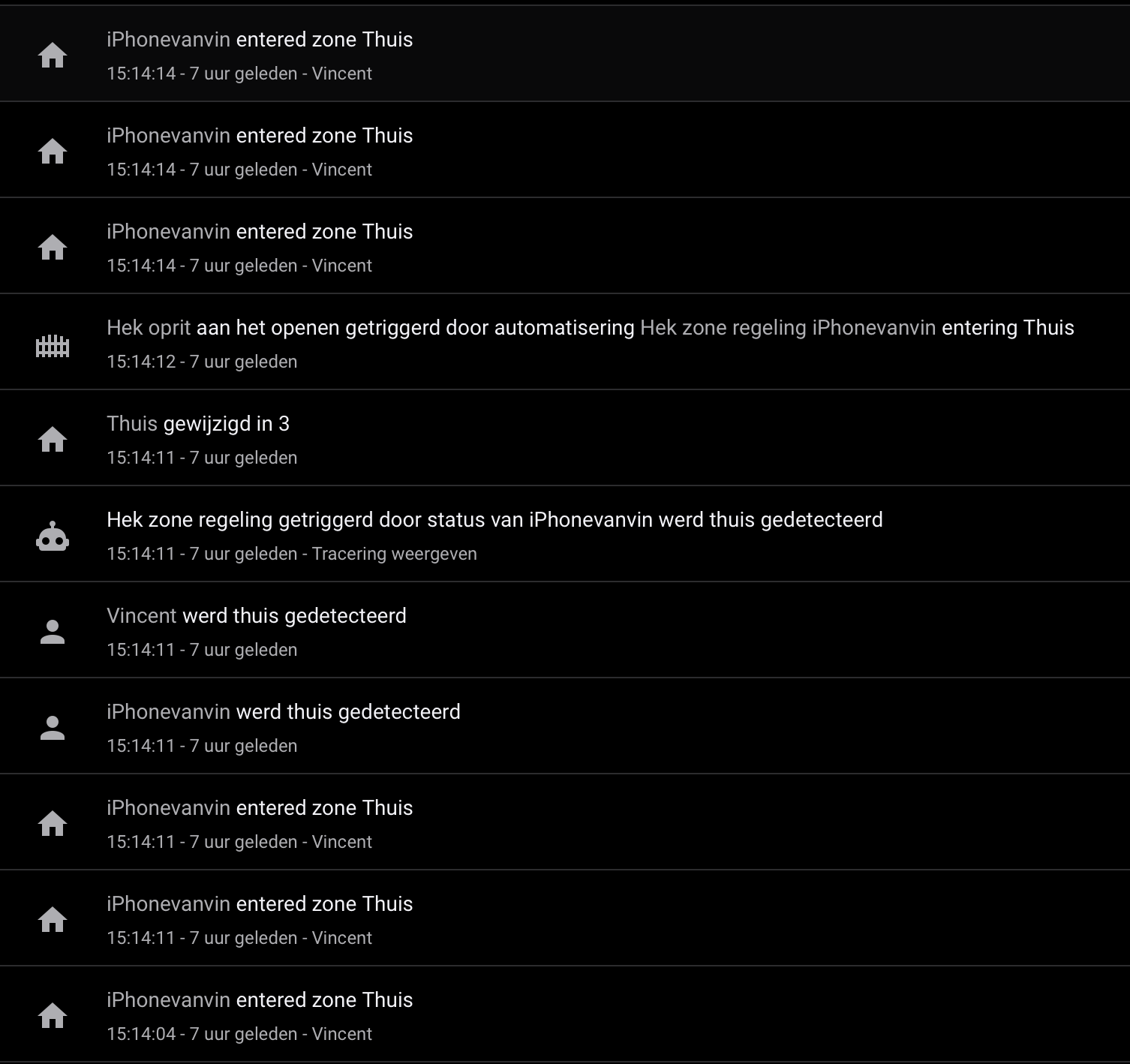

I have a strange problem that sometimes there’s a long delay (more then a minute) with opening the gate for the car.
The automation is simple, based on “entering zone” geolocation.
Trigger → When my phone enters a zone
Action → Open the gate
The gate is a nice systems IT4Wifi unit connected via the homekit integration.
What I observed in the logs is that the phone enters zone works fine, it’s fast and accurate , although I see “phone entered zone” 2 or 3 times in the log, not sure if that’s a problem.
What I also see is that the automation fires instant , so firing is fine but then, for no reason, it takes a long time before the gate actually opens (and also not always, but 50% of the time)
I checked quite some things, HA runs on an intel NUC with enough power, but I made sure it’s on performance mode.
I checked networking, wifi, etc… all good…
What is also strange is , if the gate is not opening and I press the “open gate” button manually via HA ui, the gate opens instant.
I have no idea what’s causing this… hope someone has an idea…

And a screenshot in which you can see my device entering “home” is there multiple times… why ? is this the issue ?

Would this mean your automation will trigger multiple times? I note you use cover.open as your action to open the gate. How is the gate setup in Home Assistant? Does a second trigger stop the opening?
I checked the traces and it did fire, however gate was only opening after long delay. @dcapslock , a second trigger does not stop the opening (but it should nit trigger twice as the automation is set to not run if another instance was already running…
However, looking at my phone “entering” the house zone multiple times (which I think is strange anyway) I suspected that might be the issue…
So, now I switched the automation to open the gate if an “entity” , like below and that seems to work way, way better… (also person detected in the zone is only once in the log)
