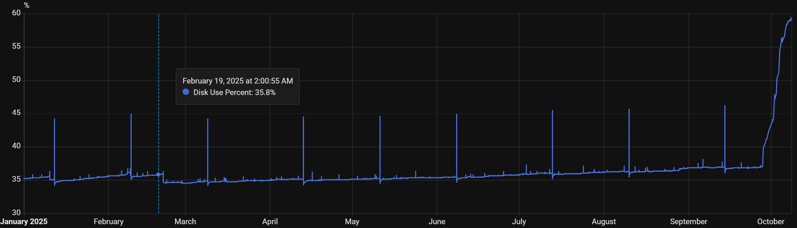

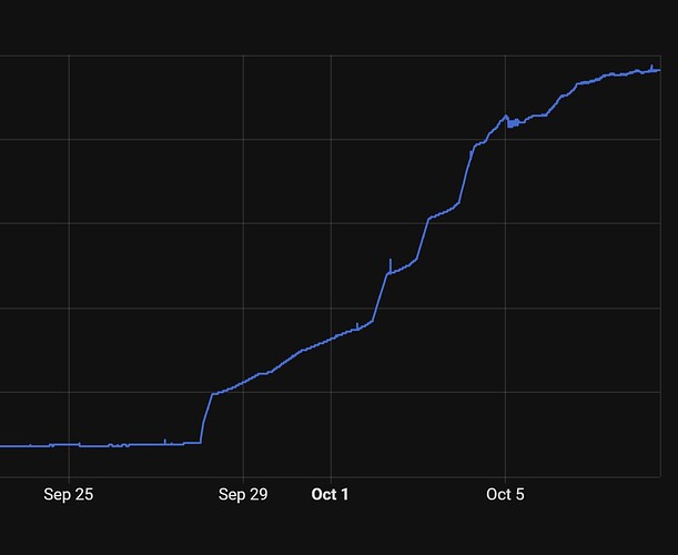

I have my system running on Ubuntu in a docker environment and it has been stable for over 2 years now. Now…since the 28th of September, my disk use has started increasing and I have no clue what the cause is or…where to start looking.
I am looking for some tips on identifying where the problem might be… Hoping anyone can point me in a direction…
Below the graph for the last month, underneath the view over the last year…
