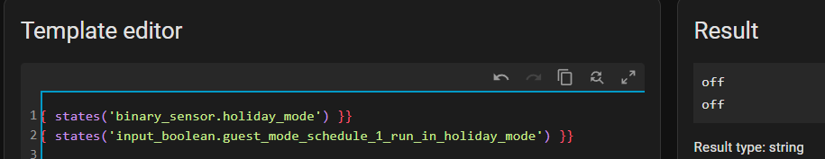

Why does this happen?
Here is the state of the two entities:
Then when I add this line it errors.
Why?
And where does the complaint about lower come from?
It looks like something to do with holiday_mode being on?
Why?

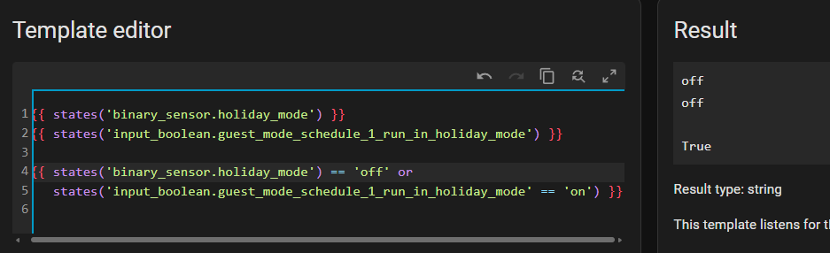

The last line in the second screenshot has its closing parenthesis ) in the wrong place.
It should not be after 'on' but immediately after the Input Boolean’s entity_id. It represents the closing parenthesis for the states() function.
Same mistake in the third screenshot.
No it’s due to the template syntax error I described.
Doh!!
Thanks.
I can’t believe I missed that…
