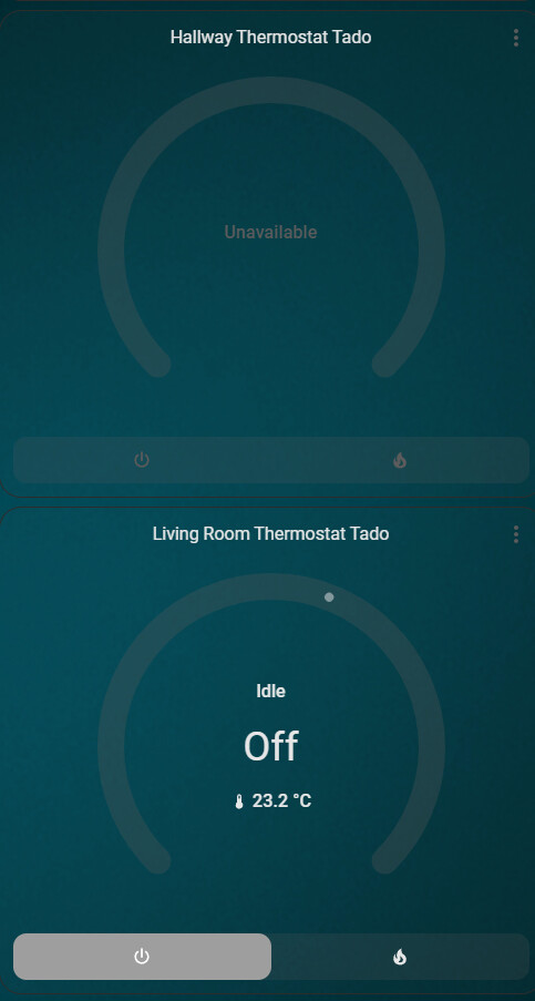

I’ve just moved my heating system control from Hubitat and i use HomeKit Device to integrate Tado Radiator Thermostats V3 directly.
Problem is that they became unavailable. At first i noticed only one of them , the closest to the bridge (2m), then all of them.
