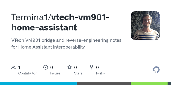

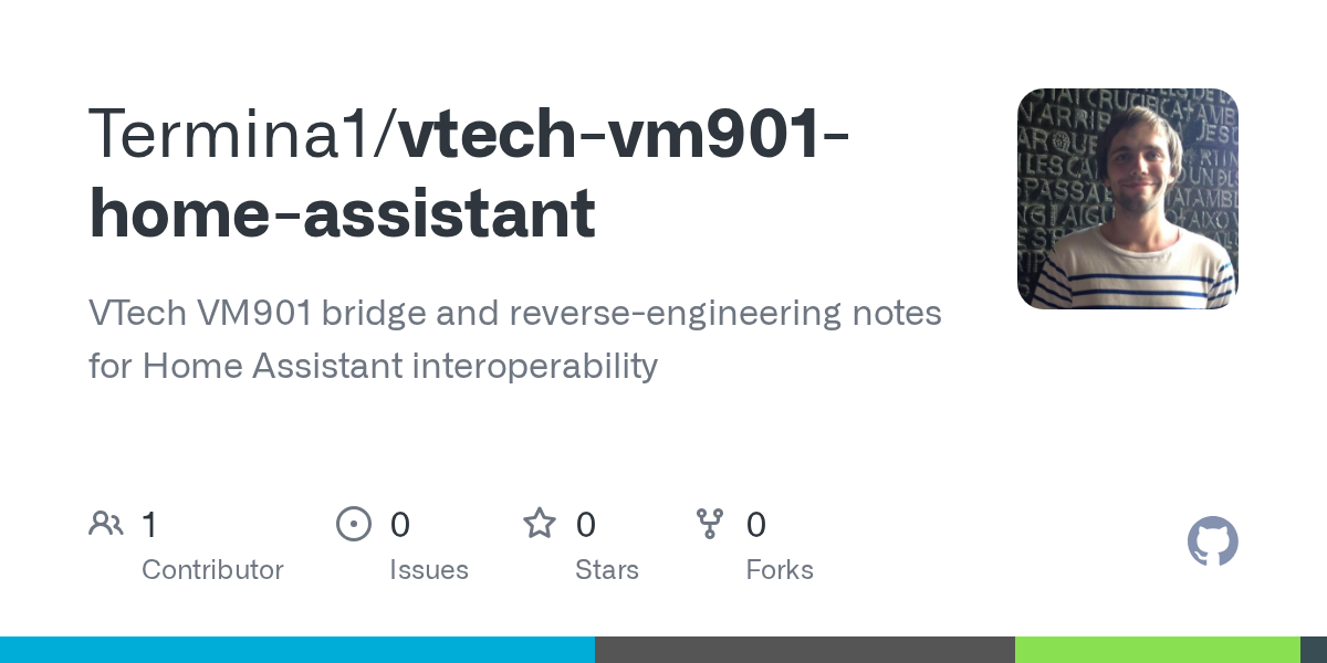

Thanks for the original research and native bridge. I adapted and extended it for the VM901:
The main difference is credential provisioning: this version recovers the TUTK license and OAuth application values directly from libsecrets.so and retrieves the UID/AV password through the VTech cloud flow.
Awesome, I’m stoked that this was able to help somebody else free their locked down device up! Thanks for sharing the repo
