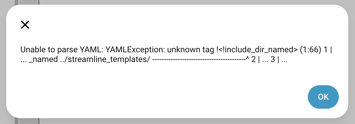

No sure I am following / understanding the setup / installation noted on the github page.
I have installed under HACS and setup the templates as described in Method 1: YAML Configuration. I have:
  • added a folder /config/streamline_templates
  • added light_template.yaml to that folder
I am confused about step 3: “Include Templates in Dashboard: In your dashboard configuration file, add:”
streamline_templates: !include_dir_named ../streamline_templates/
Where does this line go? Which file should it be added to? I have tried to added to the dashboard using the raw configuration editor but I get an error:
I note a previous comment suggesting that line is only for editing in yaml mode but I still don’t know where that line goes if I want to edit in yaml mode.
When I add a card in UI mode, I don’t see reference to the template I created in the streamline_templates, only
Not sure if I have read this correctly. Thanks for any advice.
You need to add it in the dashboard raw yaml, like you tried, but use quotes for the path.
streamline_templates: '!include_dir_named ../streamline_templates/'
There are currently multiple errors in the documentation, but there is a way to get it to work.
Take a look at: streamline_templates: !include_dir_named ../streamline_templates/ error in yaml · Issue #102 · brunosabot/streamline-card · GitHub
You can’t seperate the templates into own files, so just put all into streamline_templates.yaml
